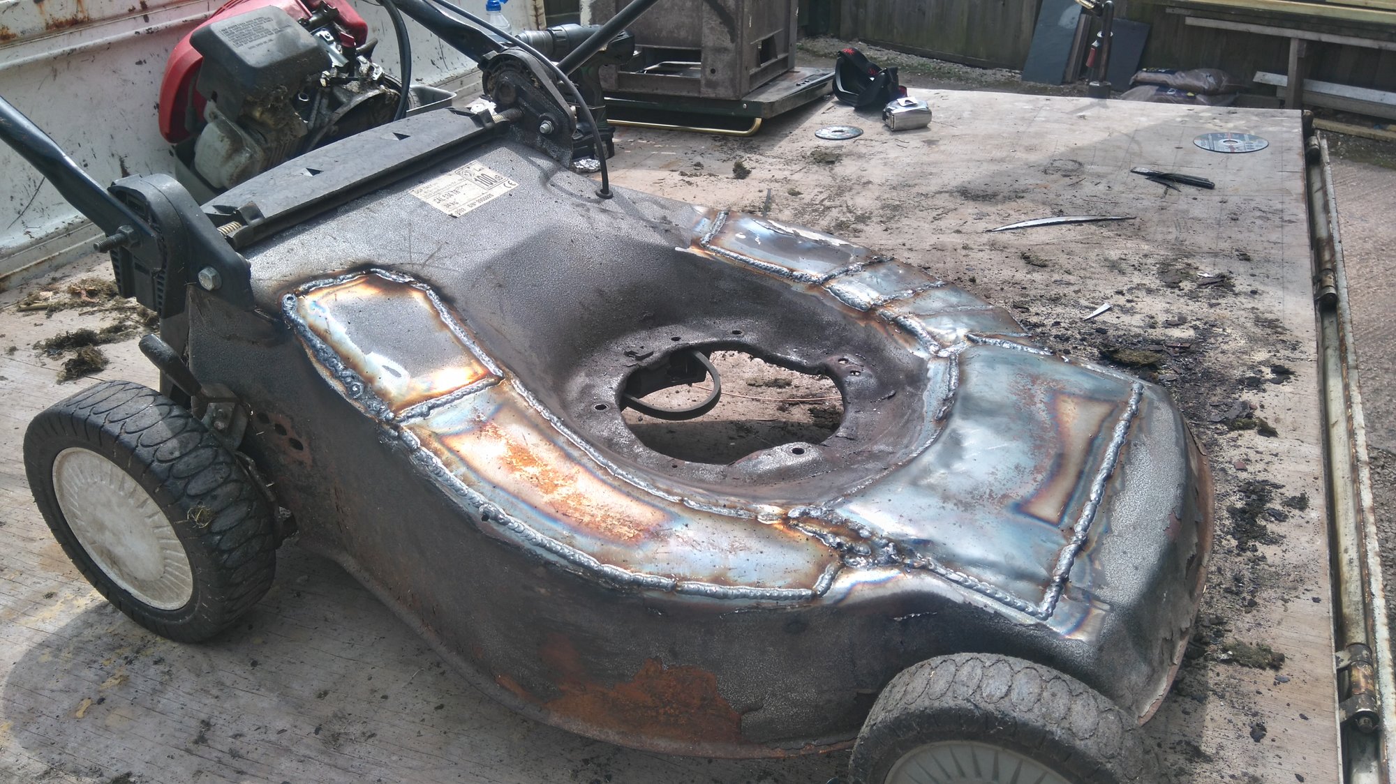

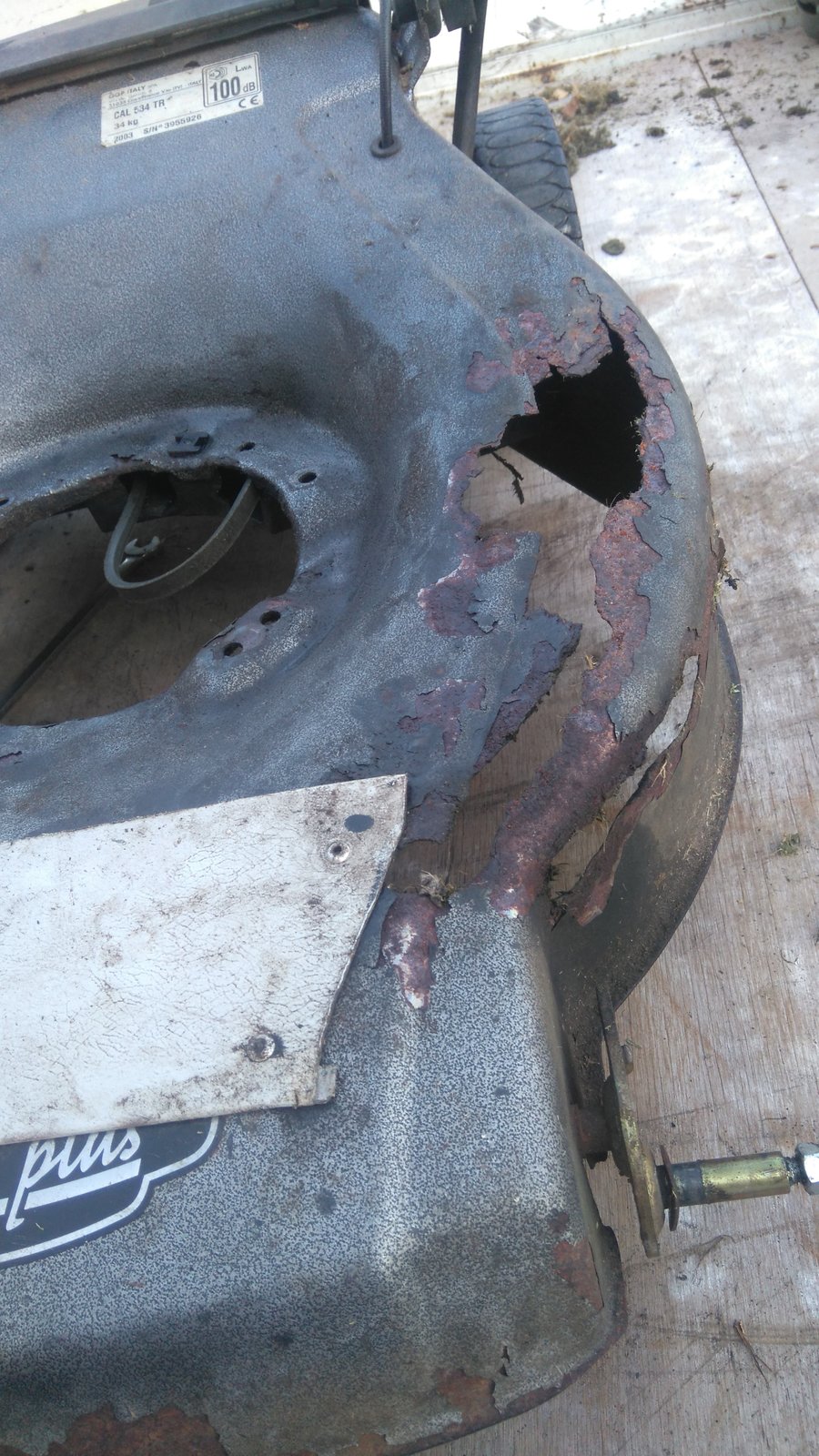

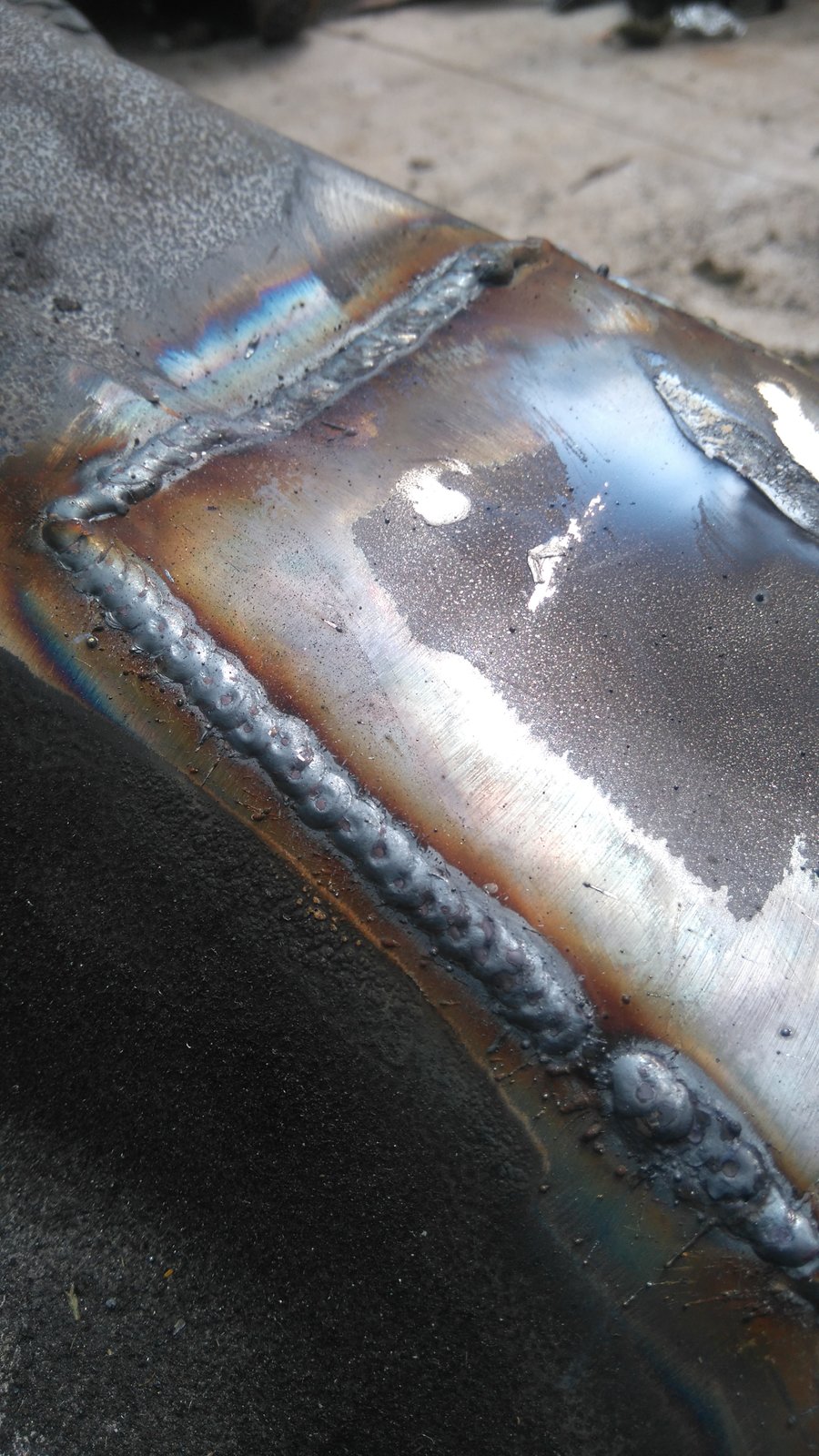

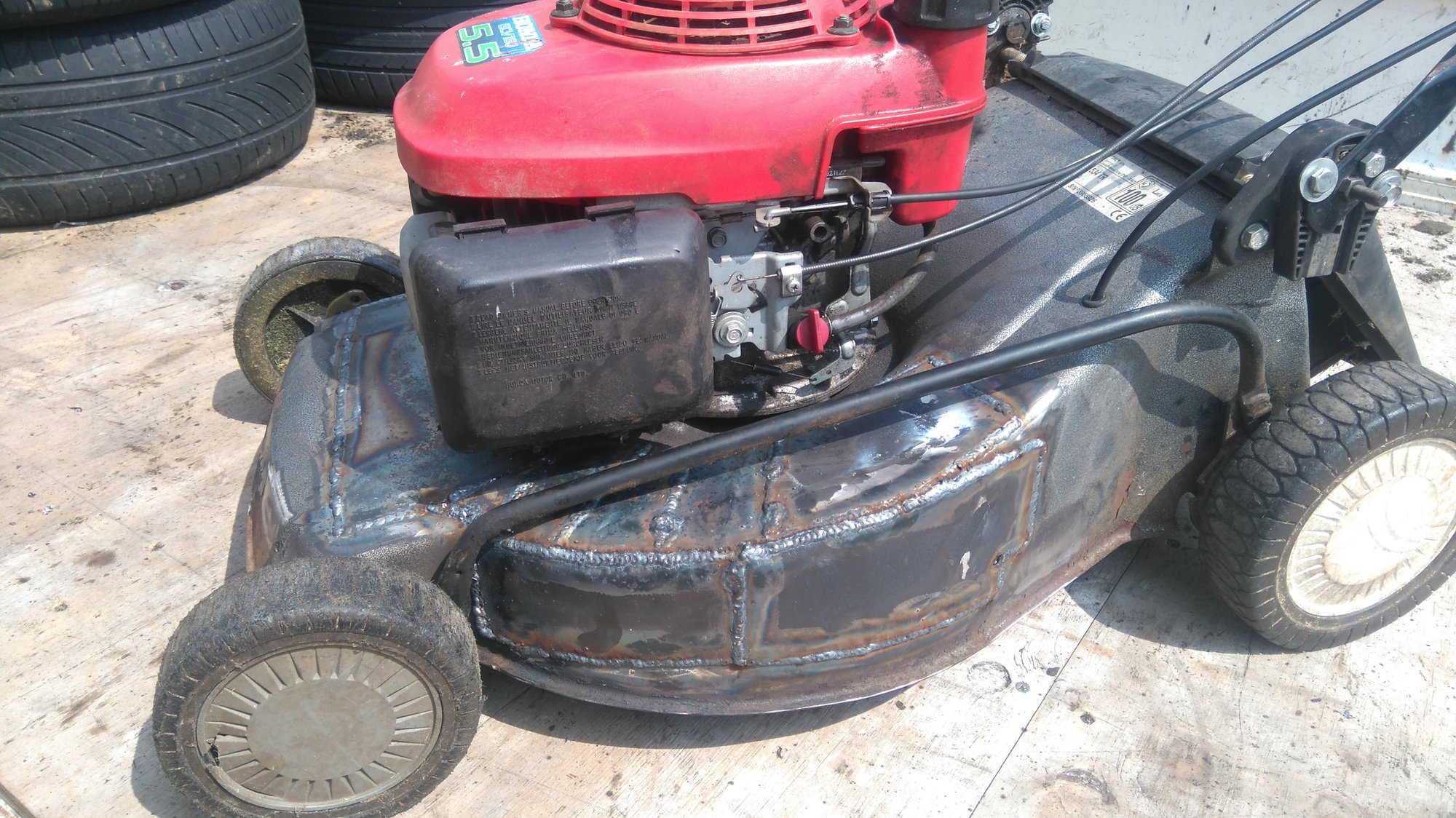

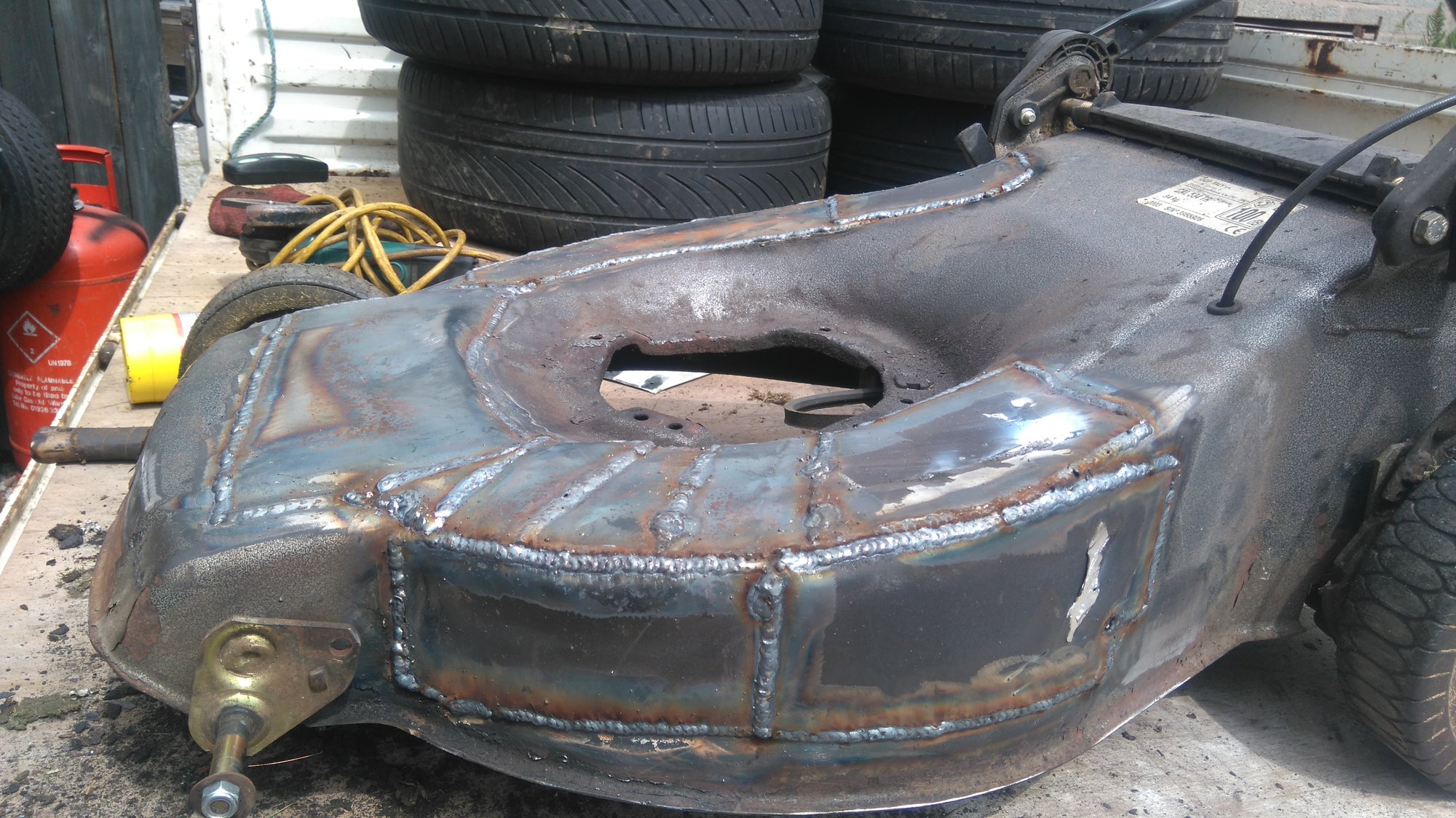

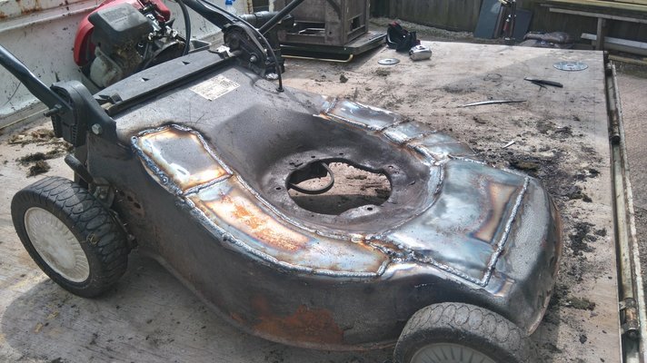

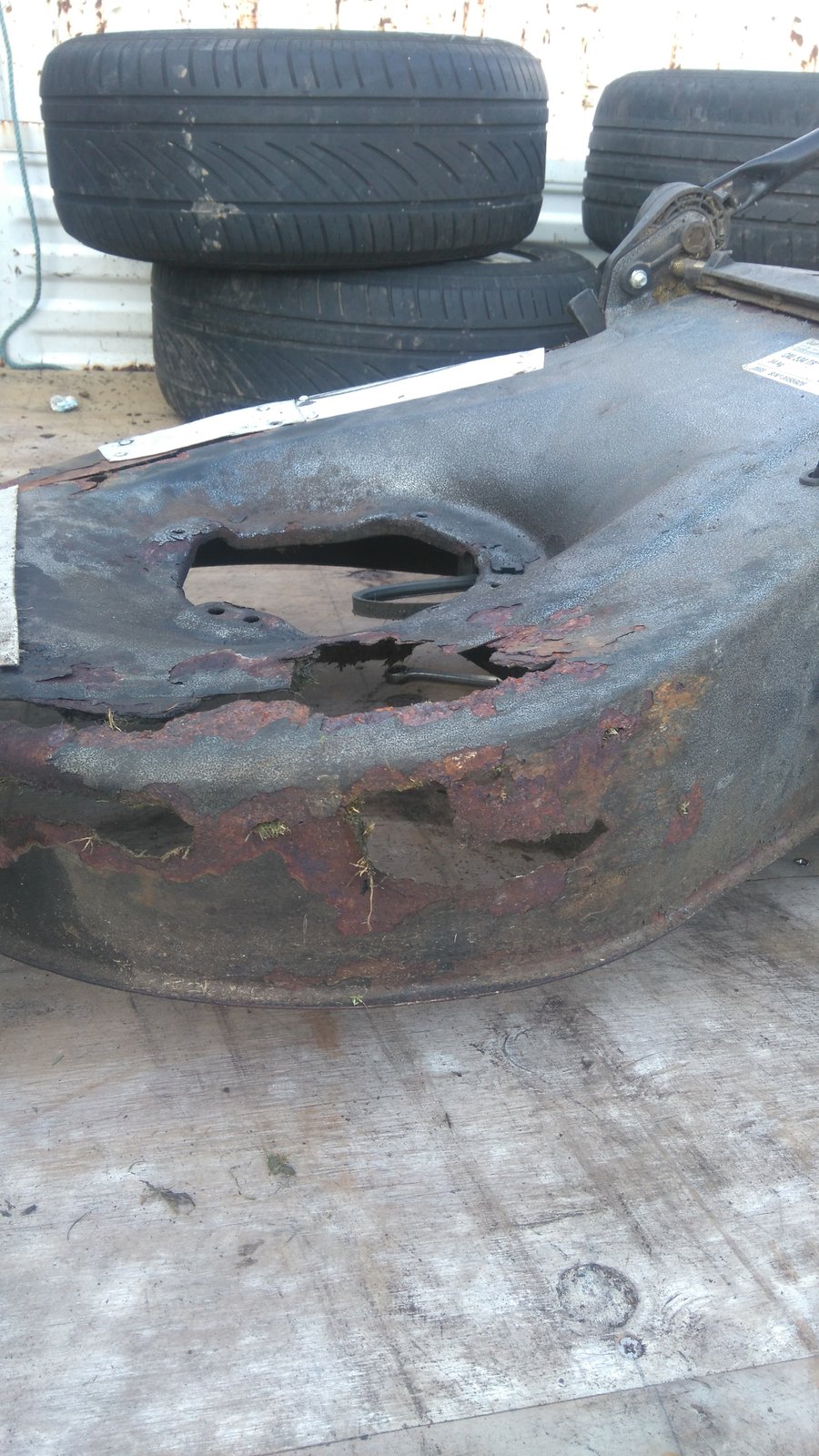

Started getting funny cuts off my lawnmower yesterday,cutting far to low so i investigated and found the motor was sagging through the frame because the old girl had tin cancer...Honda engined and far to reliable to scrap so off to the scrapyard i went and returned with a cooker door, i now have my metal for surgery..half a day later and the old girl is back into service for another few years...Anyway as always a few pics of before and after and please bear with me with some of the welds as at times it was like welding a metalic ciggy paper
