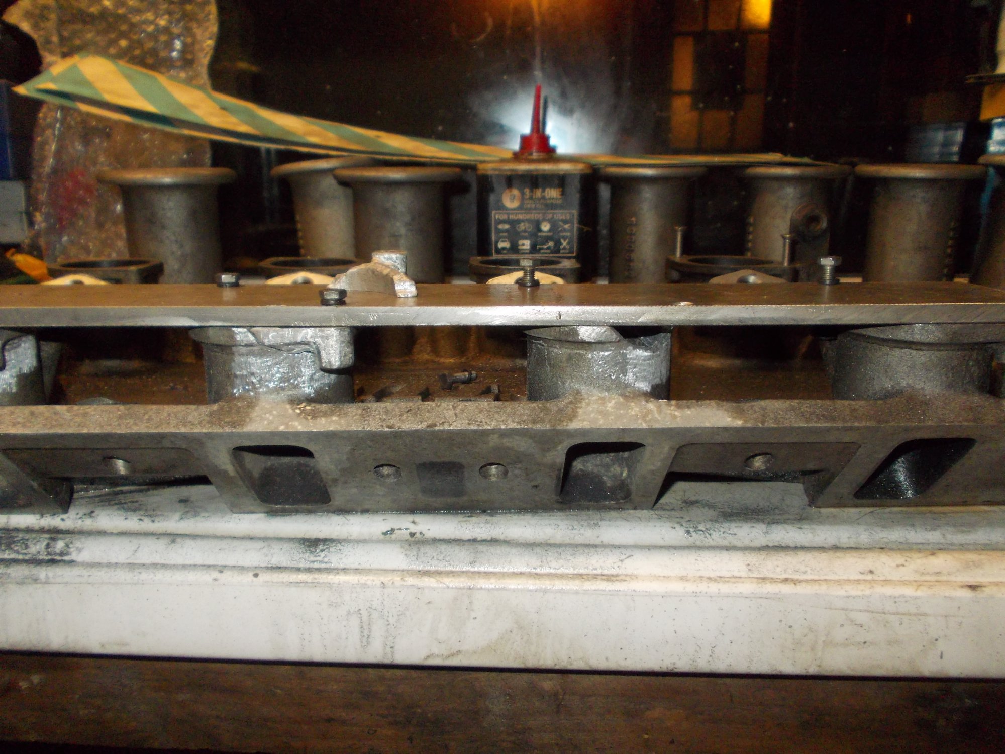

I don't have a lot of metal in some places it is going to be interesting i think i can see my argon going down on this one i ant got a fancy welder an old boc adr what sort of amps do you recommenda carbide bur is my preferred tool for mechanically digging into Rotton or oil soaked cast.
For tracking out deep cracks on something thick a gentle approach with a battery drill and drill bit every few mm or so to form a track and then dress up with the carbide bur is a really nice way of getting a good prep for a weld.
No on that I wouldn't be attacking it with drill bits I was more replying ref some of the tools techniques I use on rotton cast.I don't have a lot of metal in some places it is going to be interesting i think i can see my argon going down on this one i ant got a fancy welder an old boc adr what sort of amps do you recommend
thanks i will give it a goNo on that I wouldn't be attacking it with drill bits I was more replying ref some of the tools techniques I use on rotton cast.
I would do that based on your your 1st replys. Use the bolt holes to hold it to something sufficent.
I would v them out a little with a carbide bur and I would test the water with a torch too to see how it reacts. I think it will weld ok.
I would also pre heat it to a lowish temp of around 50-60° to help get things flowing a little quicker and aid to burning off some of the contaminant.
It's a fairly thick lump and you'll want a half decent amount of ep% helping to remove thick oxide layer
I'd say you'll be striking up at well over 100 amps but as the broken part is small it will become heat soaked quick so don't hang about when tacking it up. Big whack with good current and get the fill in. When it's tacked and hot you can drop down a touch on the current and zip round them. You'll still be up at the 100 amps Mark I'd say for the best part.

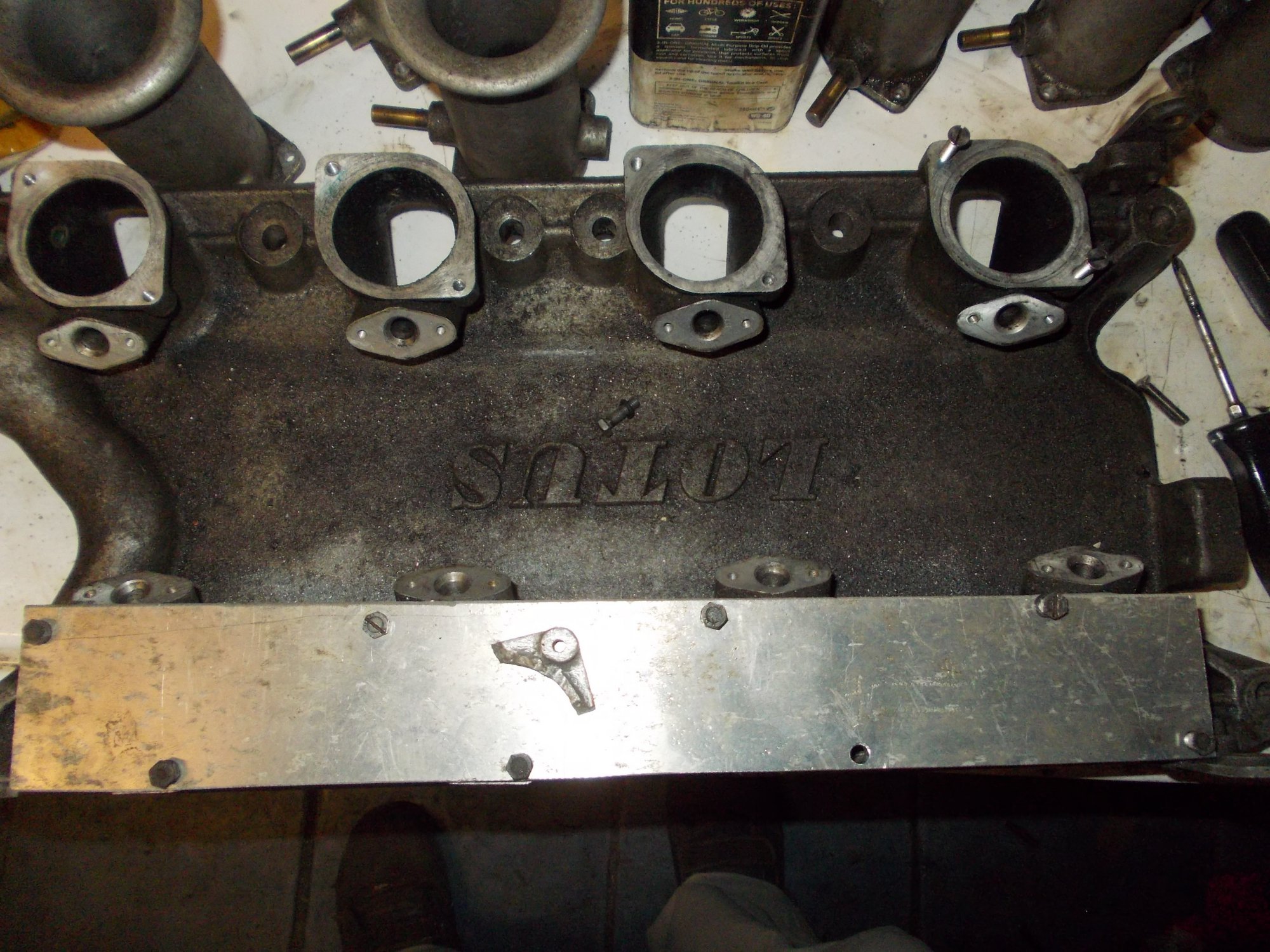

Well lets hope so i will make the plate today got other things on the do list prob weld tomorrowHello Lotus 30,
as it's an inlet manifold from a racing car (so no oil fumes being fed back via the inlet) I wouldn't think there will be any oil to speak of soaked into the casting; I hope I'm right for you sake?

Hi bob good question it is now stripped i shall go out and pick it up that will tell me but grinding this afternoon it is prob ali as it is quite tuff mag is soft i have mag wheelsClean it up with some of this gear Andy and save your marriage

I also wonder if there is a chance they are cast from mag/ali with Lotus being like they are about weight.

the rods i have are aimg 4.5mn0.7 5% mag 5% manganese 0.75 the other rod just number on rod end 3.2245 nothing on packaging made this plate today with the time i hadDo we know the cast flavour?
I'd imagine AlSi.
@hotrodder would have a good idea as he knows his castings on automotive parts better than most.
If it is AlSi then a 4043 filler would work quite nicely.
If it's AlMg casting then a common 5356 filler is the one to look at.
There are other si and Mg grades of filler but those two seem to be sitting in most people's stock.
Will burning the shaving work for telling if it is magHi bob good question it is now stripped i shall go out and pick it up that will tell me but grinding this afternoon it is prob ali as it is quite tuff mag is soft i have mag wheels
Hia peaches just been out and lifted it its ali not mag thanks for the idea thoughWill burning the shaving work for telling if it is mag
