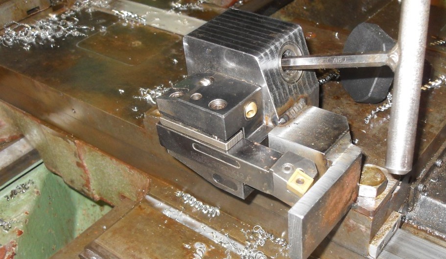

Bought this a few weeks ago. Man! a wonderful little tool.
http://www.ebay.co.uk/itm/252759450384
Setting up the tool height is painless in half the time. Those with a million tool holders permanently set up probably doesn't need a tool like this, but for those with only 3 holders changing tools often, it makes like so easy.
It has also highlighted problems indicating that my tool heights keep moving. I now know that I need to make some improvments to my holders to prevent further problems. Explains why I have had some inconsistent finishes.
