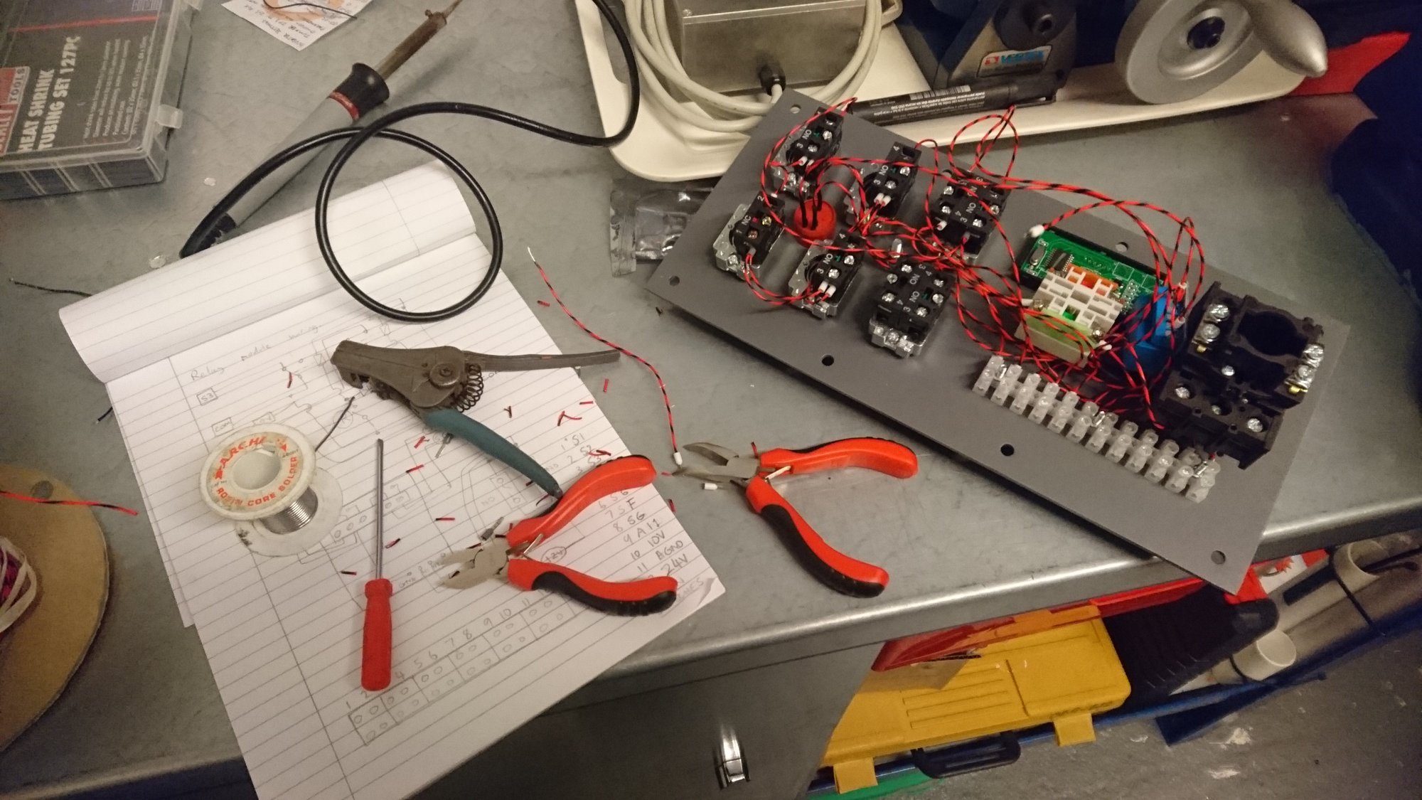

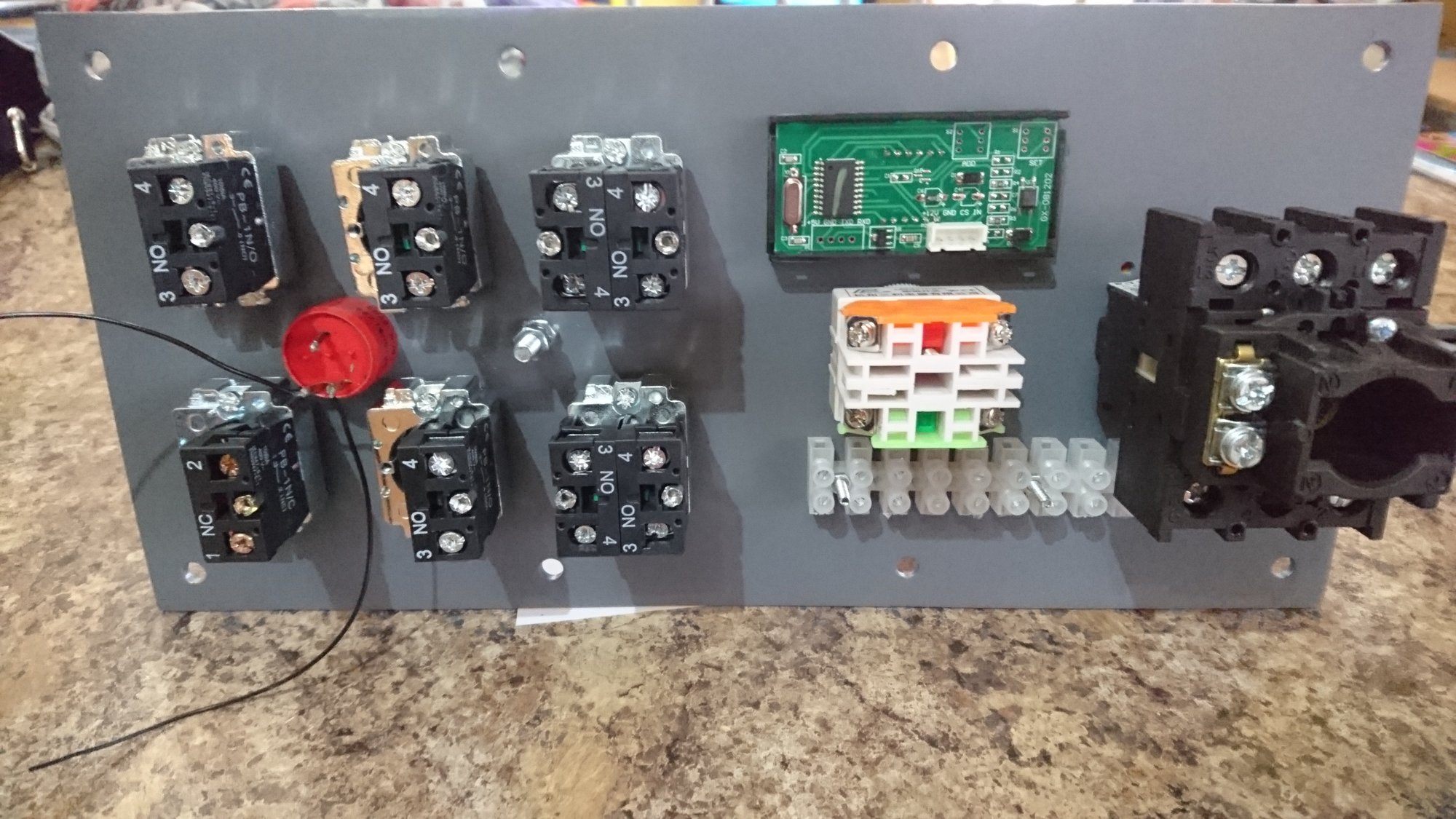

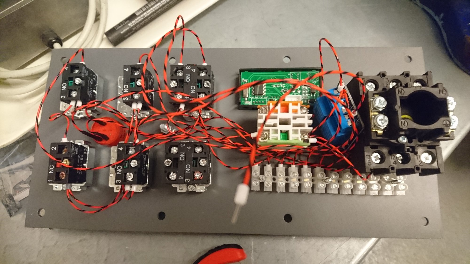

I agree with you Farside. I have been trying to get hold of some of the brown bakelite terminal block as was used on the original.
Unfortunately there isn't enough room for DIN rail type stuff, as there wasn't on the original.

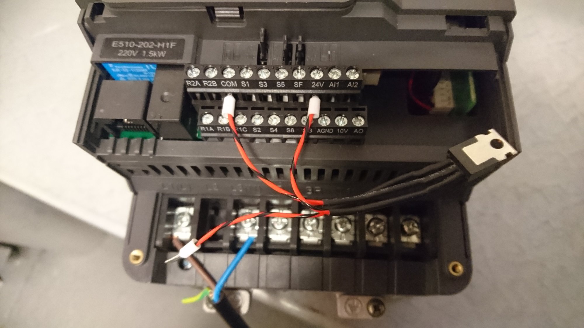

It's all low voltage from the vfd control terminals that will be on that block. That said, I would still like to replace it with something better.
