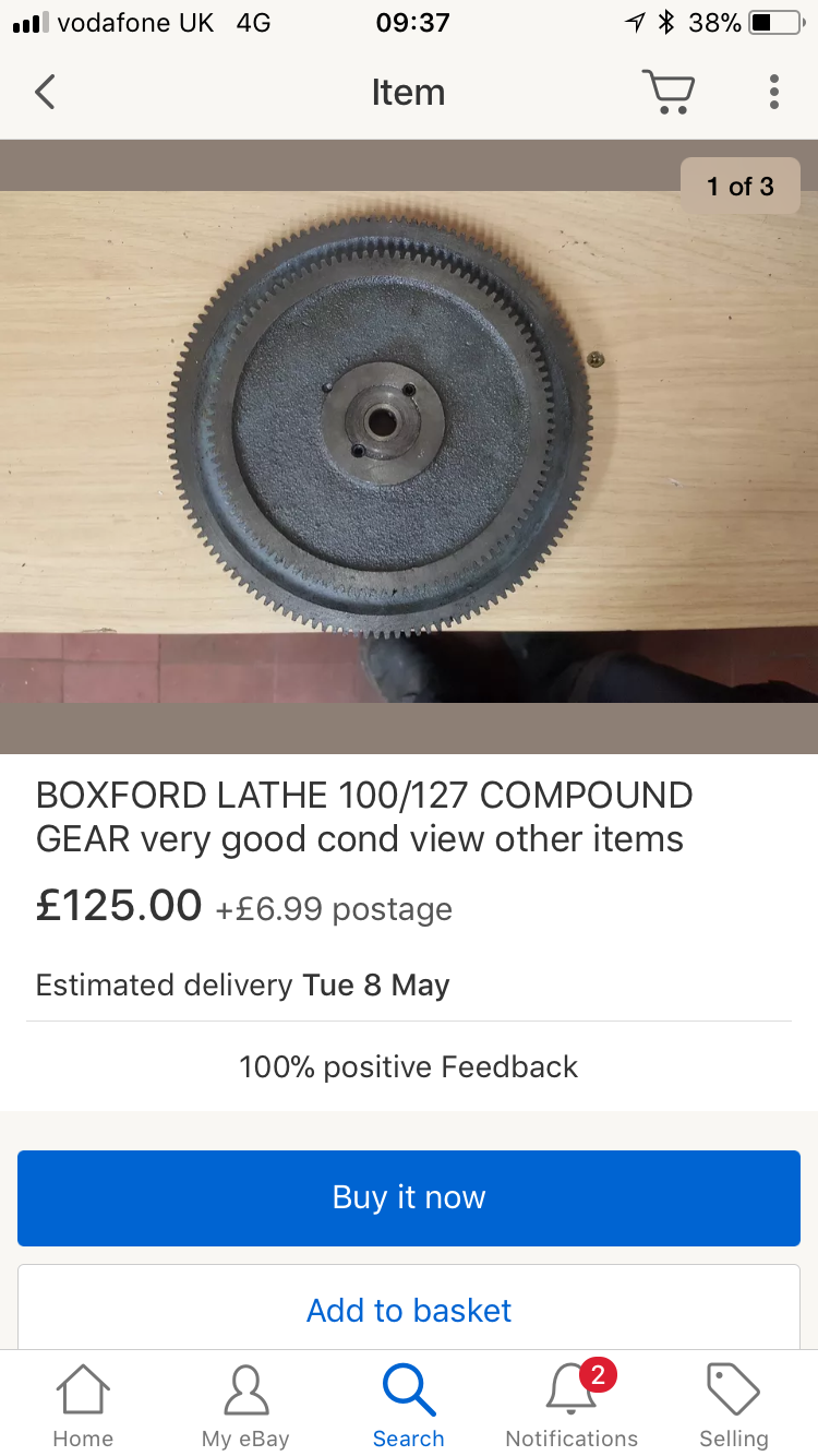

Oh ok.Except he need the 127/135 to cut imperial on a metric Richard
Boxford use a 100/127 compound gear for metric conversion. You would be close enough for with 50/63 I guess. Unless you're cutting a screw of some length.

Im trying to cut a 8tpi thread on a metric boxford to duplicate the splndle for a little project. I thought a 3mm pitch would do it but it doesnt. Is there a way to do this without imperial change gears as i dont have any.

100/127 - Imperial to metric
127/135 metric to Imperial
Does this go for all lathes?
Fairly pricey. Not sure if it’s a good deal or not but once you’ve got them you’ve got them and it opens up many more doors.

Probably worth it if you do a great deal of imperial but mainly metric, but to rich for me who would only like to do the odd imperial, as I mainly use it to make hard to find or expensive parts for European motorcycles, but occasionally the odd British bike,
