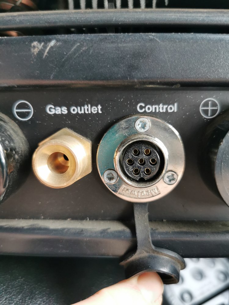

X xbl New Member Messages 5 Location Chester, UK Nov 12, 2021 #1 I've just happened across a Stealth DigiTig 180PD, needs a new torch and I can't find any with the 7 pin connector fitted, see the pic for reference.

Kram Member Messages 6,228 Location Sussex Nov 12, 2021 #2 Whats the diameter? A xs12-7-reverse might fit. Reverse means pins are on the cable plug, 7 is number of pins, 12mm diameter, however the body of yours is recessed. Worst case, open it up and replace the bulkhead connector aswell, with one of these https://www.amazon.co.uk/dp/B07W4HCTT2/ Note they are a pain to solderthe 5 pin I imagine 7 will be 50% worse! You might find something searching for "DIN 7 pin". Cant see diameter listed for this might be worth asking them. Lumberg SV70 7 Pin Male DIN Plug IEC 60130-9 Straight Cable Mount Lumberg - SV70 - Lumberg SV70 7 Pin Male DIN Plug IEC 60130-9 Straight Cable Mount - <P>Circular locking cable plug from the Lumberg SV Series, straight www.rapidonline.com

X xbl New Member Messages 5 Location Chester, UK Nov 12, 2021 #3 The thread is 18mm and the inner is a gnats todger over 12mm. If it can be replaced with a 5 pin then I assume 2 of the pins are not necessary?

H hotponyshoes Member Messages 6,421 Location Somerset. Uk Nov 12, 2021 #4 You need all 7 if you want to run a foot pedal although you could use a 5 and a separate switch
Kram Member Messages 6,228 Location Sussex Nov 12, 2021 #5 Stick with 7 pin, I just meant it was a pain to solder mine which is a Sherman with 5 pin. The link should show a 7?

500e Always buy fire insurance a flood is a hard start Messages 8,569 Location South West Nov 12, 2021 #6 Try the multi pin HiRose for fiddly
