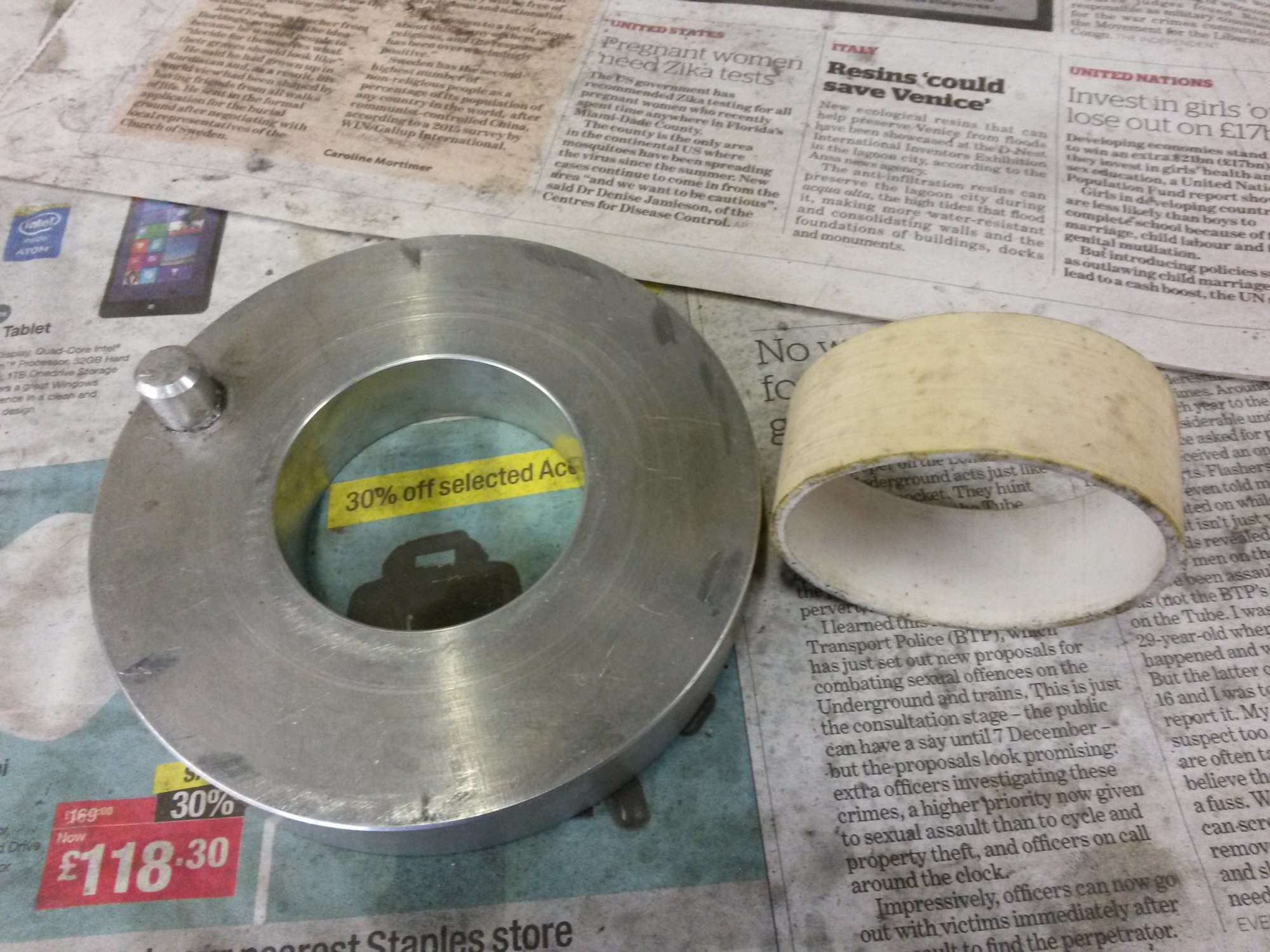

I made the one for my Portamig with a 50mm hole through the middle. The spigot is 10mm. The hole to accept the spigot on the machine spindle is 12mm. The centre of the spigot (and the corresponding hole for the machine spigot) is at a radius of 45mm. I made mine 20mm thick (just sets the reel out a bit to improve the line-up of the wire). I also use a spacer on the outside made from a short length of drain pipe. I hope that helps.
