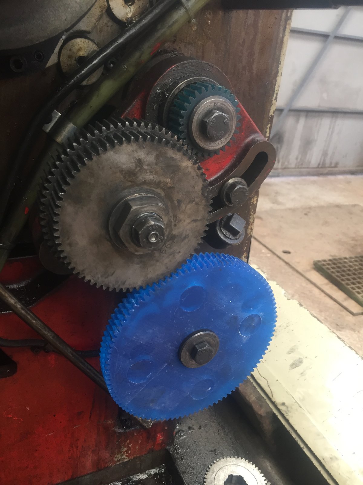

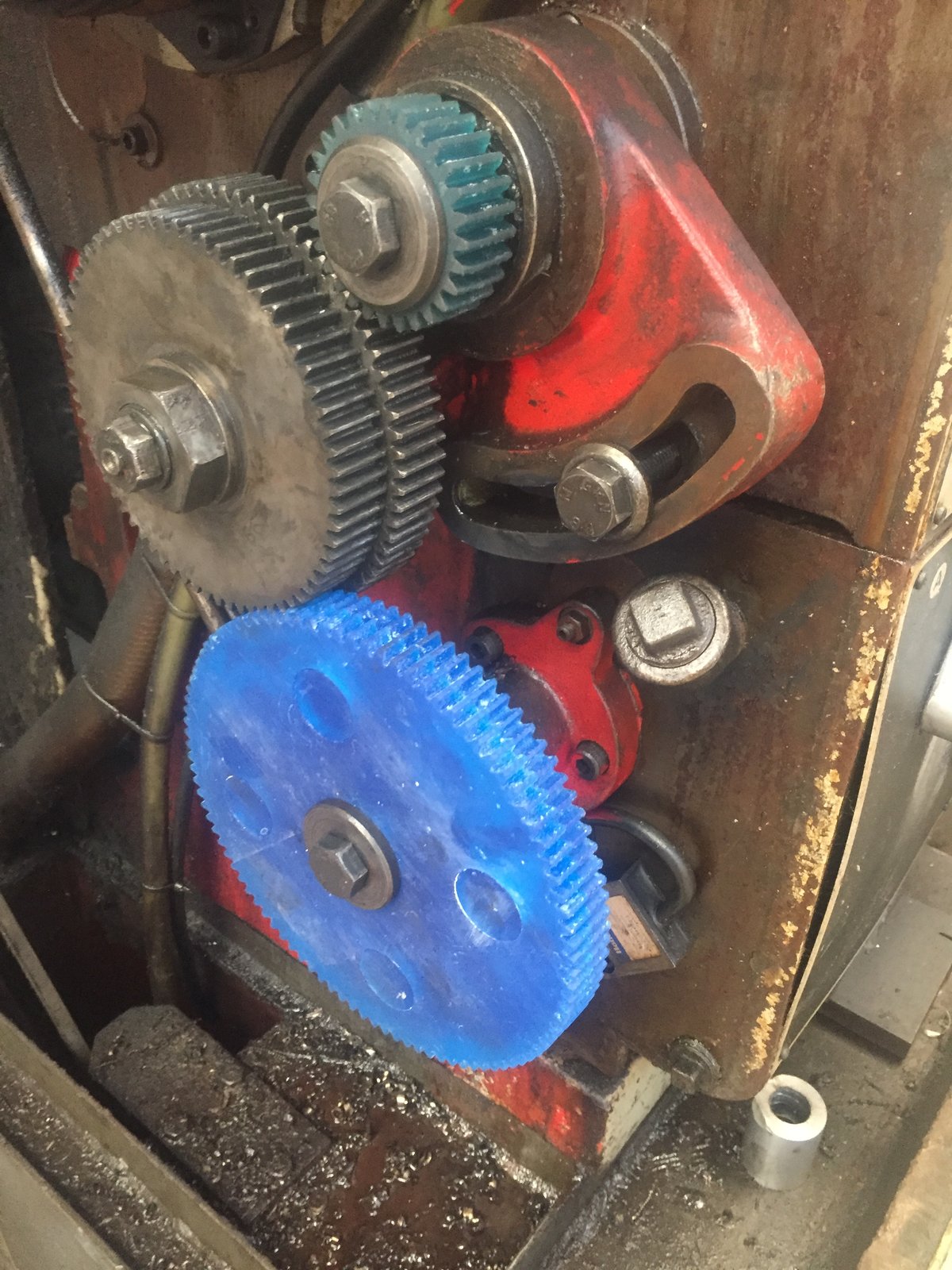

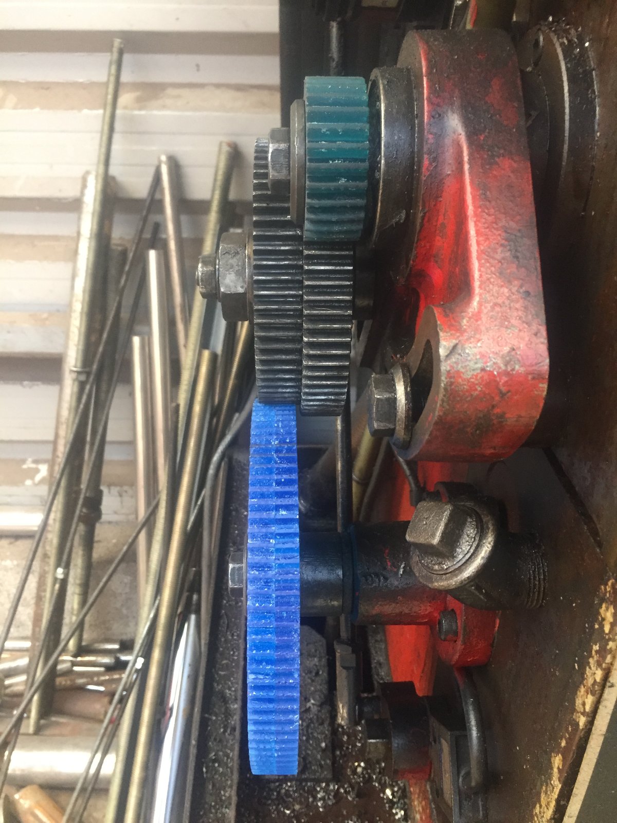

back last year I aqquired a harrison m400 , When I bought it it came with changewheels for cutting 4mm to 14mm pitch and nothing any finer! Spares from the 600 group were painfully expensive so I've been doing all my thread cutting on my smaller harrison l13,for which I have no metric translation gears......
I saw a thread on here about 3D printed gears so I got in touch with Richard Oakley who's a member on here and he made me the 28t and the 96t gears that I was missing to cut finer threads.
I received them yesterday and just did a trial fit. They are a great fit and mesh together with the existing gears perfectly.
