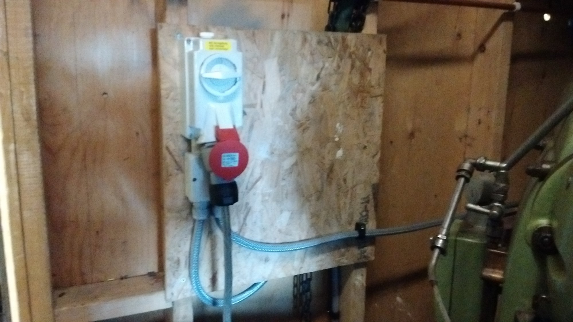

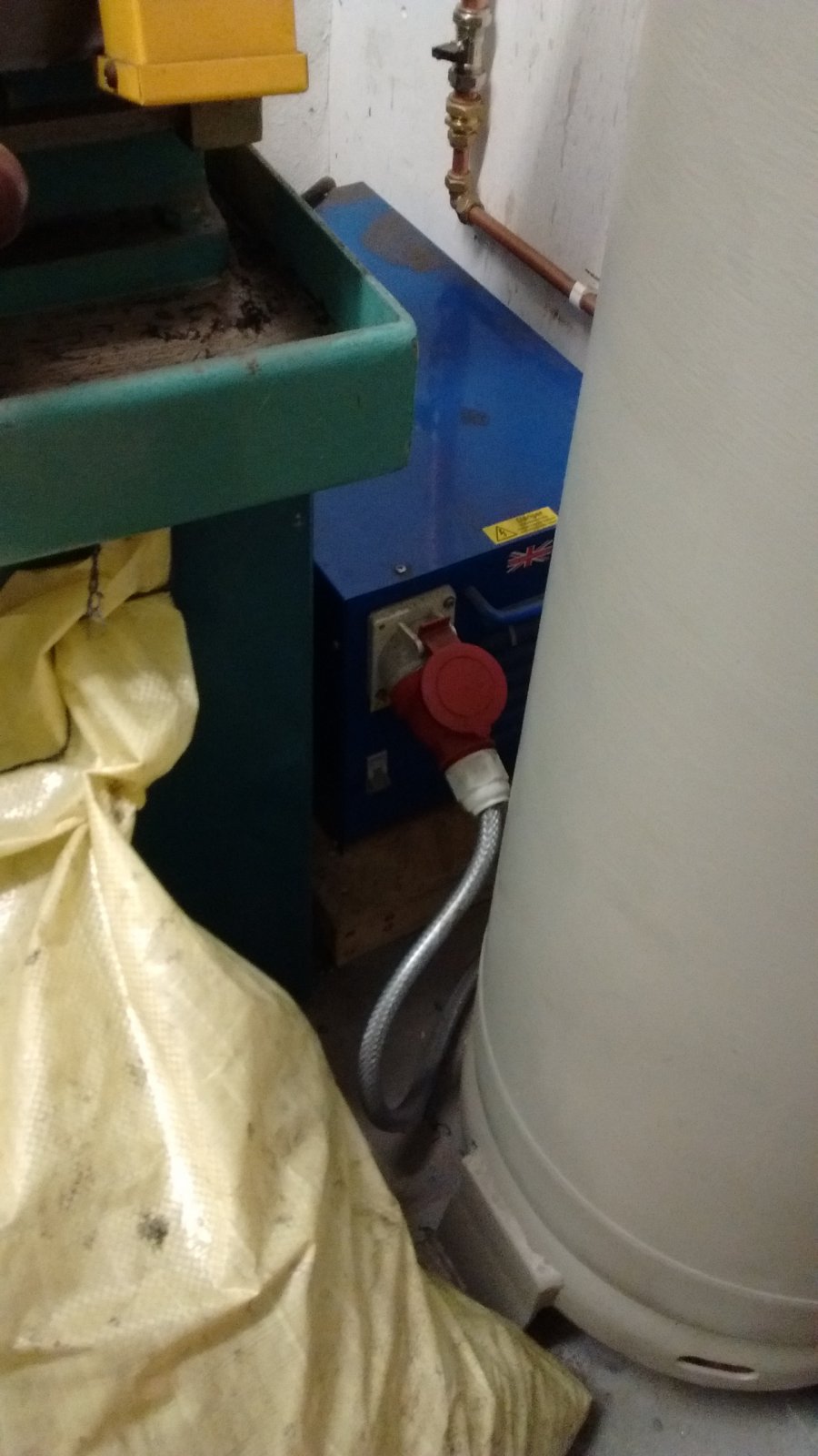

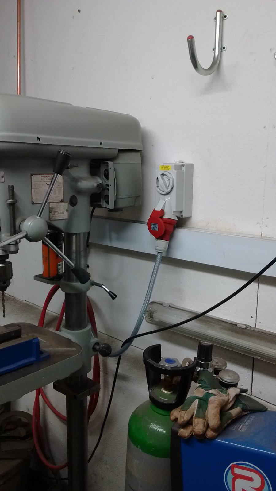

I feel as im getting ahead of myself since I've only just joined up, but I run my workshop off a converter. I've now got a big rotary converter running a ring main which is great. I used to have a 7.5hp static converter linked to a free running motor to balance phases, without the balance motor it was a pig to start heavy loads and it would burn out small motors if running on their own. RIP my pedestal grinder!
