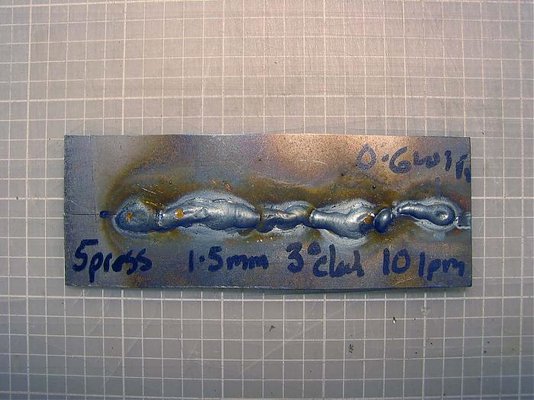

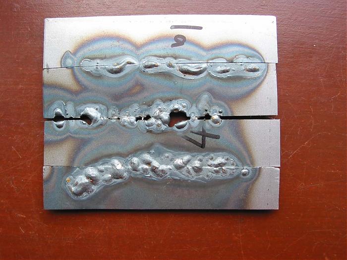

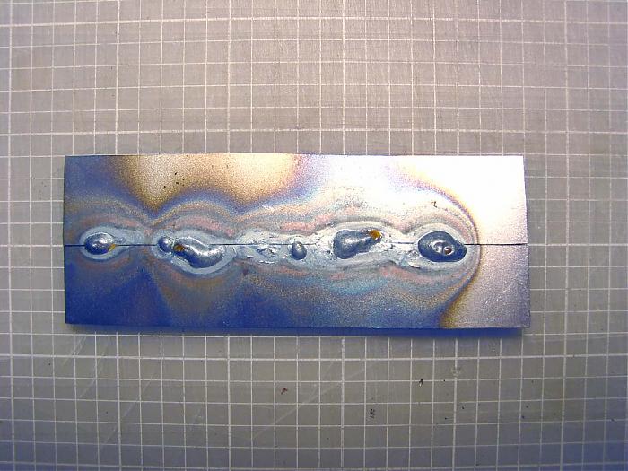

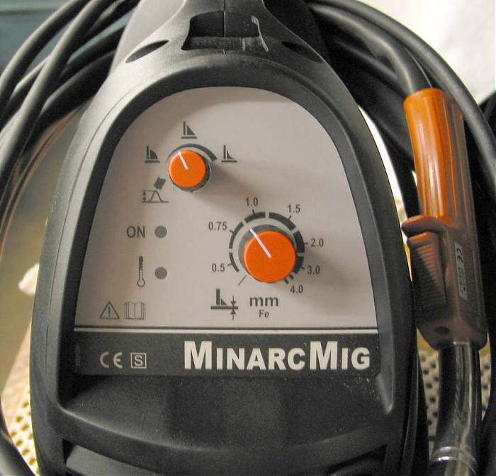

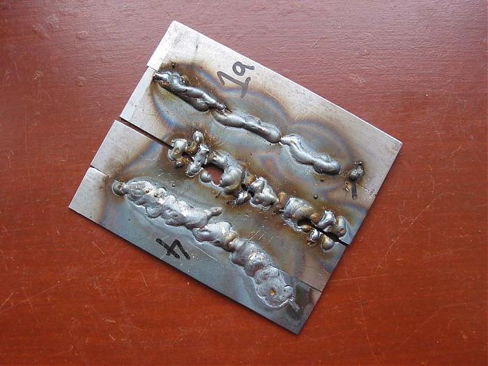

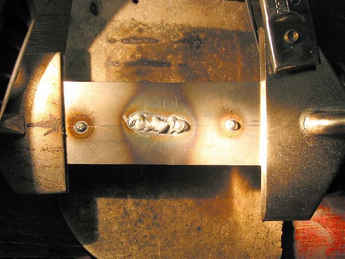

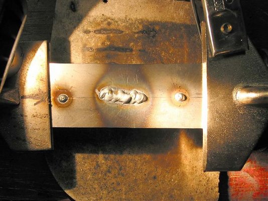

Kemppi MinarcMig 150
0.8mm wire
10 lpm Argon mix gas flow
20 gauge mild steel

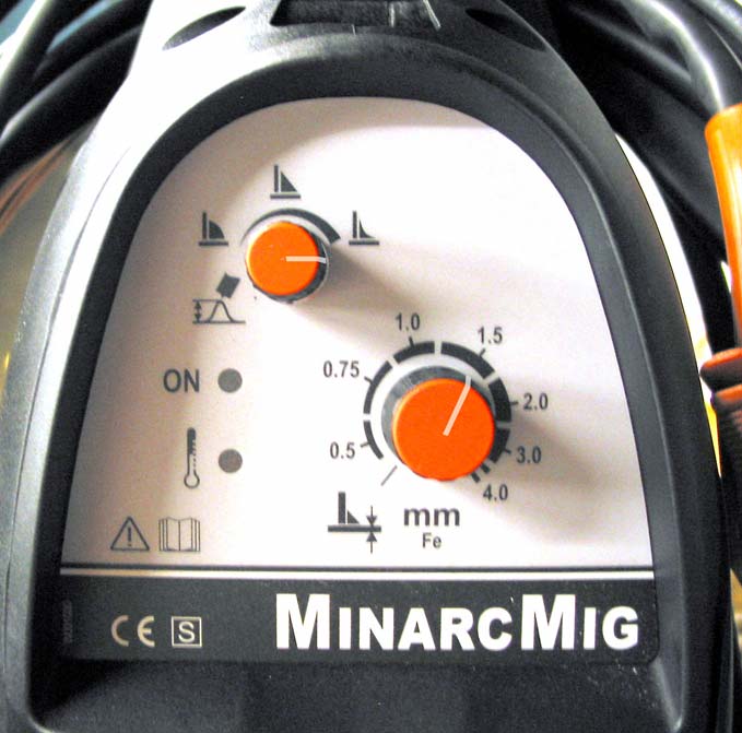

Top dial is arc length trimmer - clockwise=longer/hotter
Bottom dial is metal thickness
This is just one set of many test pieces since I bought the machine. Started off by using 0.6mm wire but got fustrated trying to find an optimum setting where I could get decent penetration. Changed the wire to 0.8mm, which is what the sheet thickness dial is based on, and got on much better penetration-wise. Still looks like pidgeon do-do, HELP.
Andy

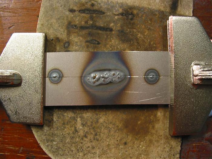

0.8mm wire
20 gauge mild steel
Andy
