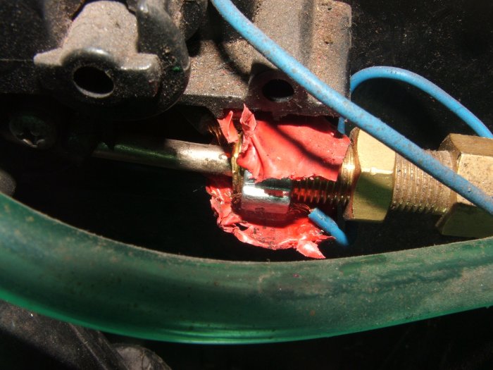

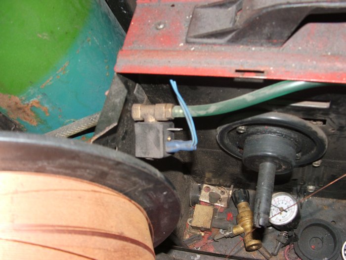

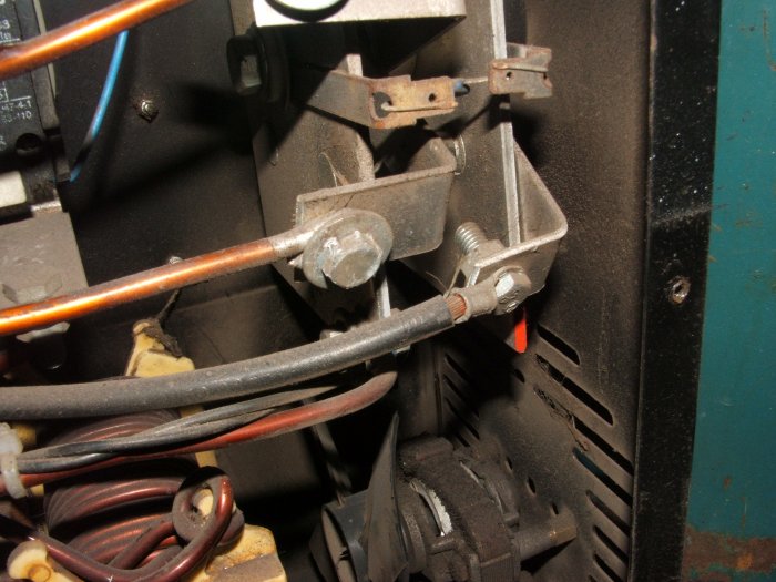

Not fancy doing a euro torch conversion on it then?
....... and if you run over it, it only takes 2 mins to fit another.
You've done a conversion haven't you RTB? If I recall, you got your parts quite cheaply?
if your ordering form http://www.welduk.com/Results1.asp?Category=46 youll need the conversion kit, the gas solenoid and a torch, an mb 15 will do fine and will be the cheapest, youll also need some wire, crimps, a drill bit to bolt the solenoid to the casing and something to cut a large circle at the front for the adapter (holesaw or dremmel would do), you should pm weldequip asking for the parts and he'll give you exactly what you need![]()
