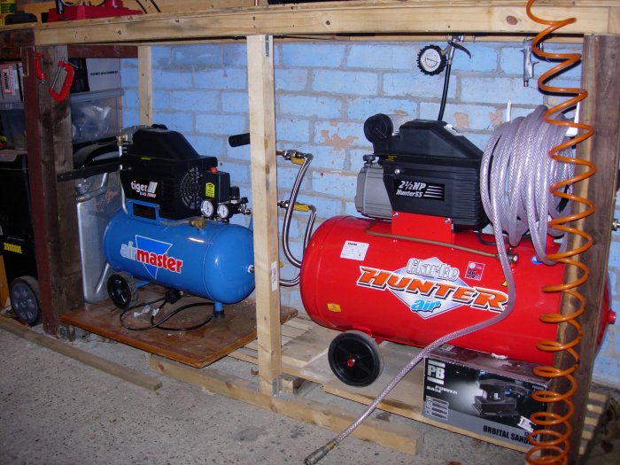

The basic setup is shown here:

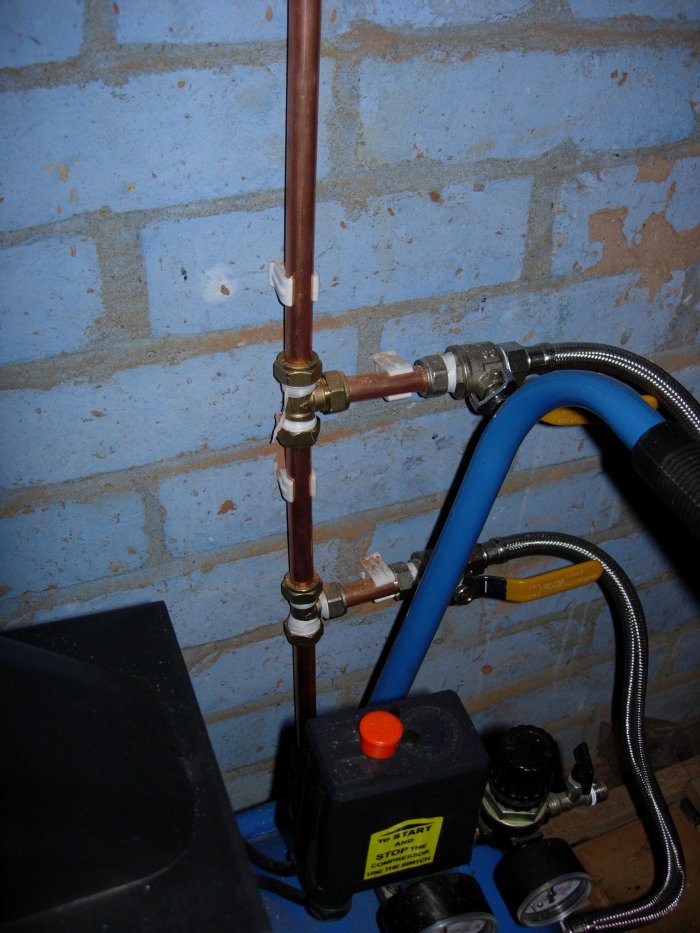

Kind of following Malcolm's guide, I have plumbed the two into one common drop leg, both independently controlled by a Ball Valve, with a Ball Valve at the bottom of the leg, to allow for drainage.

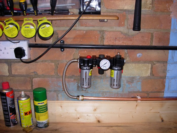

The drop leg makes it's way up, through the workbench and into a combined filter / regulator / lubricator:

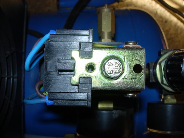

The pressure switch on the smaller unit looks like this:
Now, I'm guessing that this type of switch has a pre-set (and unchangeable) upper cut off (8 Bar, in this case). So, it follows that the adjuster must alter the lower cut off? Can anyone give me some guidance on this.
I'm guessing that I only need a marginal difference between the cut-in pressures (1 Bar, or so?) Again, guidance will be gratefully received.
All in all, I reckon this was a Sunday afternoon well spent; theoretically, it now gives 15.7 CFM and 74 Litres, from a combined 4HP!
