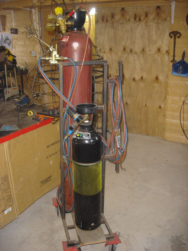

First Oxy/acetylene tidy. I have seen people struggle with sack trucks with massive acetylene bottles, scary to watch.
A much better solution, large castors are a must, 2 of them are braked (not broken), mobile and safe.

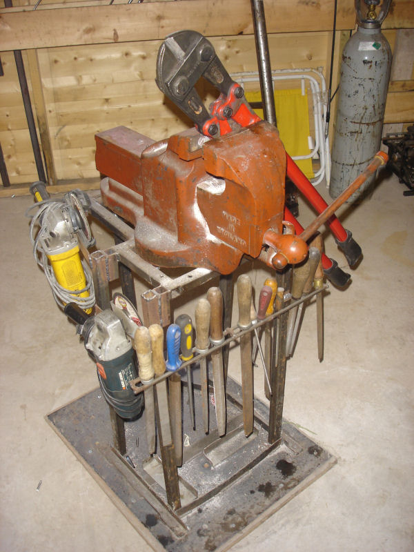

Next I was sick in my old place of everything jumping off the bench whenever I walloped my vice and it's contents, I also like to have everything to hand.
I was going to bolt it to the floor but it seems handy to be able to drag it around. I was given the vice in response to an internet message asking where I can get one, big thanks to Jock for that.

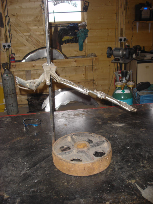

I also like things to stay where they are told when I am welding smallish components together, havnf several times and failed to graft myself a third arm on I came up with this, very useful.
