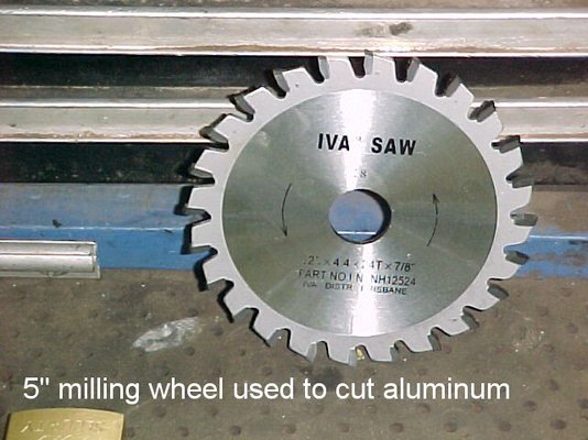

I notice in your advise page on aluminium Malc, you mention that a grinder wont cut aluminium very well....You can get discs especially for cutting aluminum, but theyre slightly dearer than a normal disc.
http://www.screwfix.com/app/sfd/sea...&q=&n=d21420&pn=1&pd=1&pi=1&cn=1&cd=1&x=0&y=0
If you want to cut larger sections, or grind aluminium, just use a STONE disc :idea: they dont clog up with the aluminium.
