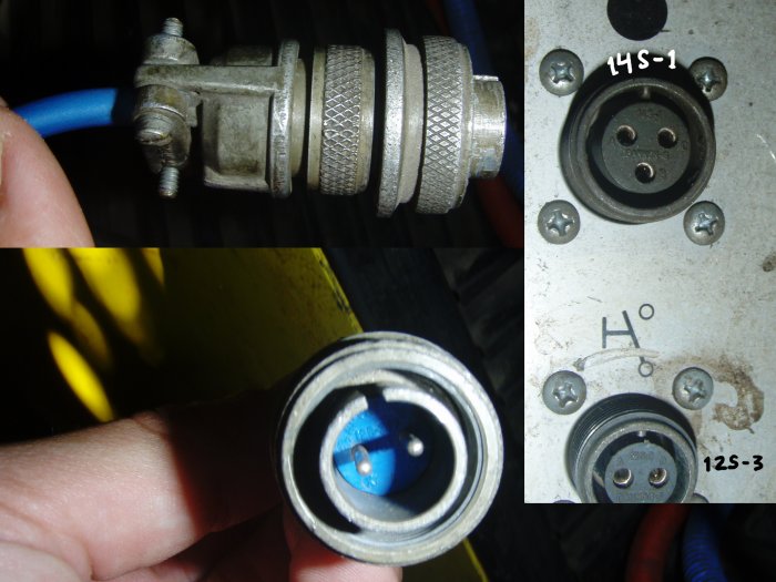

Im about to make myself a footpedal while i save some cash for the original (Esab FS 002 which is about £1k !? thats twice what I payed for the welder with water cooling unit).
I have found an old pedal from a sewing machine which is sooo simple to modify. Inside is an old wired resistor on a ceramic cylinder. It has multiple out-takes connected to 8 metal blades seperated by insulators. The pedal simply squeezes them together to sequentially join more of the resistors in series i guess. This will control 0-100% of what the welder is dialled in to deliver. I will simply replace the resistor with seperate modern ones adding up to the correct total resistance needed for my welder (old Esab DTA 200 AC/DC).
However, since there is only 7 discrete steps at hand, should I make it linear or will I want smaller steps in the bottom or the top?? Which would be the most usable?
Then I must figure out the cabling. But I have problems sourcing the original plugs used (one two-point for the switch and one three-point for the amp control). They are Cannon/Amphenol plugs (12S-3 and 14S-1). Where would you find aomething like this?
