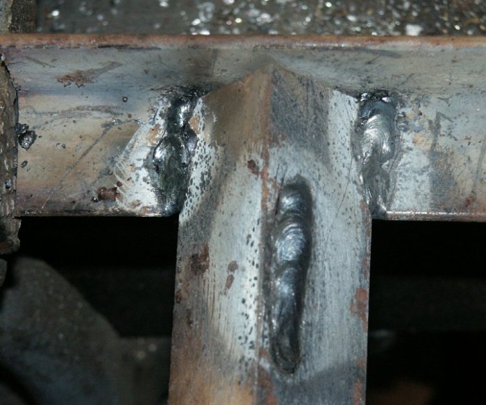

Still fighting 6013 rods and inside corners.
I just cant get them to work reliably on inside corners.
Here's some test welds with my new Fleetweld 47 3/32 (2.38mm) 6013's:
2nd from left is actually the 7014's I love using, but I and determined to get 6013's working.
Here is what i am getting:
If I turn up the power any more it just start eating away the edge of the steel (1/8").
The upper right shows the slag inclusion (entire center half of wel is not fused to lower plate.) I paused for 2 seconds with a weave on the lower metal before crossing back. You can actually feel the rod hit the hardened slag as you weave (about a rod width weave.) Guess I need a real long pause as the base metal will take much more heat.
Hard part is you can't see the weld pool at all due to the slag. I have no issue with larger rods as there is less slag that weld pool.
I did find they work much better on AC. I thought DC would be better, but AC definitely is cleaner and the arc does not "cling" to one side. Looks like the rods are optimized for cheap low-OCV AC welders (says so on the box.) Maybe not nest with this 90 OCV beast.
Guess I'll be using the 7014's. I can use them with no weave and have no problems with slag inclusions.

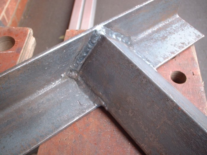

You can see better too. Just need to get a steadier hand and balance.
