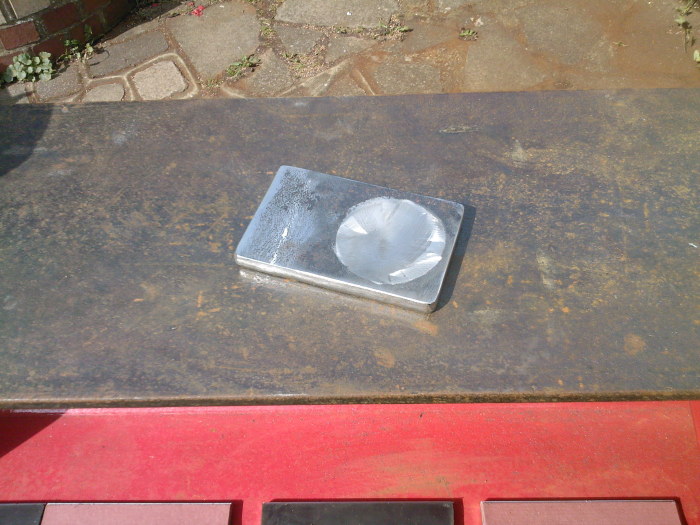

I've got some nice dome ends on my (yet to be finished
) TV stand here;
I do them with this doming block I made;
It's made from a piece of flat section (FS) mild steel 10mm x 150mm x 100mm and, this one, will dome up to a 75mm diameter piece of metal.
The basic bowl shape is made using a 125mm angla grinder with 115mm cutting disc on it. The cuts are made from the bowl's centre point from various angles. The bowl is then smoothed using a 115mm fibre disc on the same angle grinder until the shape is uniform. It takes about 20 mins to make.

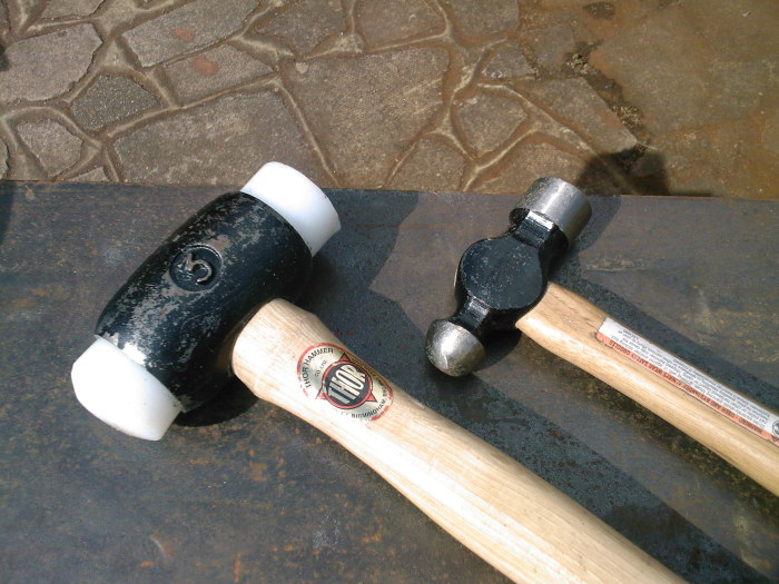

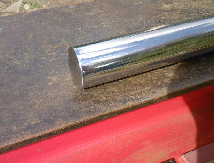

To make a dome I cut out a circle of metal first, to the correct size of the tube it will be welded to.
If the metal is under 2mm thick I will use the super plastic hammer shown in the left of picture (I've rounded one end of this one with a fibre disc for this purpose). If the thickness is over 2mm I will gently use the ball on a ball pein hammer to concave it.
The dome is then tacked in place and then seam welded and cleaned up. Easy
Happy doming...
