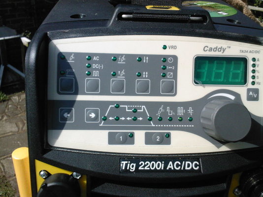

Sorry about the pics (the bike isn't part of it! ). I didn't think it was a particularly elegant solution at the design phase, so... I didn't bother documenting it...
Hey... you folks can figure it out!
I made it on this with the help of some home made, 'v' blocks which I have documented and will post up later.
Murex / Esab wanted 300 notes for their efforts...
...errrh.
Didn't want a cart type trolley because it takes up too much, valuable, room. The Tig caddy (tig tray bit) had a different design in CAD, but I changed my mind at the final hour. (KISS protocol)
to this:
Doner trolley from B&Q £19.99
All I swiped from it was the toe plate, axle and wheels. Only realising later that the metal from it is "not quite right" and I couldn't get a really nice MIG bead off it. The same was true of the "p" handles which were recycled from a cheap old tv stand. The new metal from Parker Steel welded very well and I guess I'm expecting more, and more, of this "dirty recycled metal" in the future. (So that's one "recycling thing" to avoid then.
Shopping list;
B&Q Trolley
Bit of B&Q chain
Remnants of a cheap TV Stand (v. hard to find
RHS - 28mm o/d x 3mm.
FS - 25mm x 3mm
EA - 25mm x 3mm
Increased the toe plate to axle distance (from original trolley) to make the footprint much more stable.
Top of Tig machine is the same height as my shoulders. I was also worried about stability, but it's all good! I'm much happier with it, at the end of the day, than I thought I would be.
Thanks for looking!
