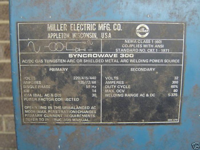

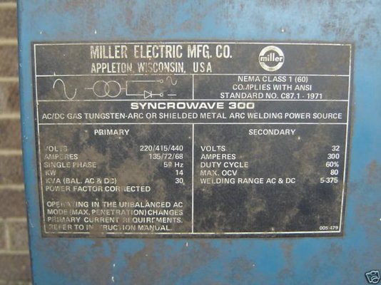

That's a typical example of what I've said on here in the past about those big tigs on ebay, the guy has been using it on a 415V supply so therefore assumes it's 3 phase but............look at the data plate
