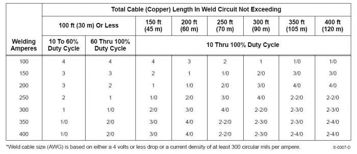

Folks, the work return cable on the Miller is a bit manky so I'd like to replace it. My question is, if I use 35mm2 cable, what's the maximum length I could sensibly go to bearing in mind that it's a 310A machine but I can probably only squeeze maybe 220A or so out of it? Would also probably do the MMA work lead at the same time. I think the leads are currently around 4 or 5m, what length leads do you have on your own big machines?
The earth lead and interconnections on mine are 70mm but you can even get plugs for 95mm!!! No idea whether any 'normal' welder uses anything that big though!
. I reckon the stuff on the miller now is probably 75mm2 or so, possibly more.
