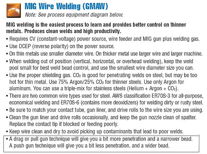

still new to mig welding , have done a little bit of stick welding over the last 6 months. i am finding it so hard to push and welding torch away from me. if that makes sense. maybe i got used to the stick welding were you draw the stick towards you.the pushing away from you seems so unatural. when i cut a piece of wood i cut towards myself, when i draw a straight line i draw towards myself, or if i was cutting with a stanley knife i tend to cut towards myself. when i have done mig welding and drawn the torch towards me the weld looks fine. your views please
