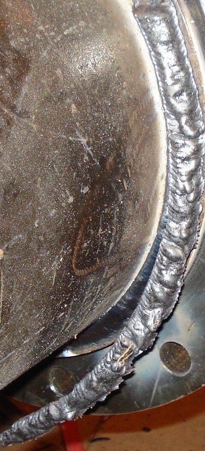

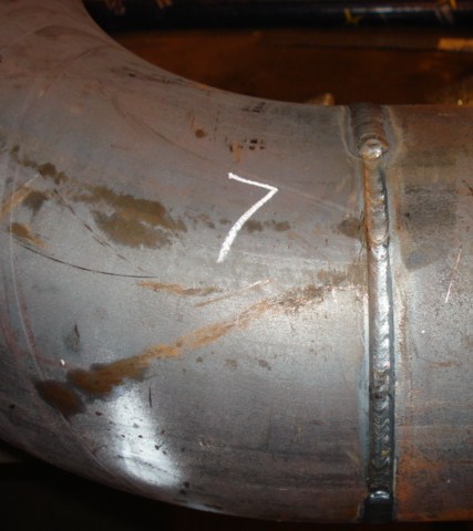

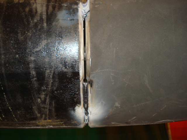

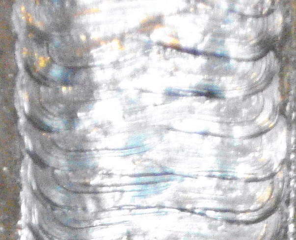

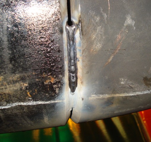

.they really are a versatile rod,this came from a 12 ins butt i did a while ago,just an attempt at close up.lads i can explain the way i go about root filler and cap,but only that there are lots of methods,and mistakes.
f/j

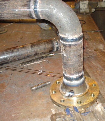

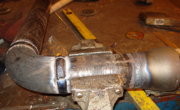

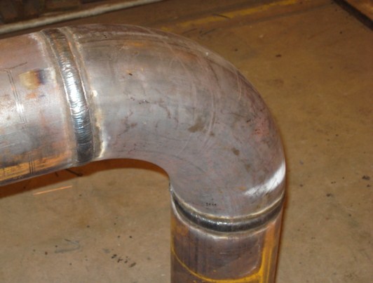

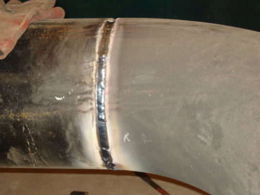

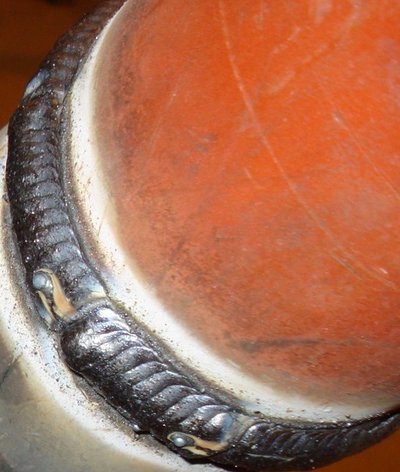

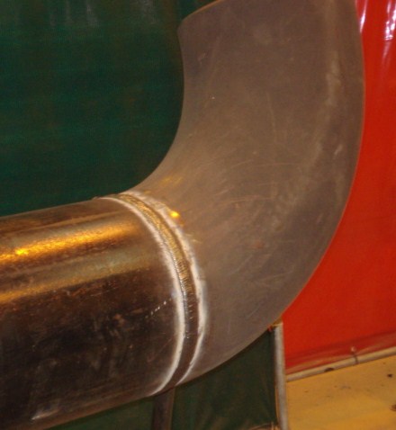

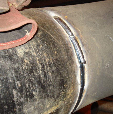

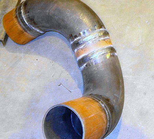

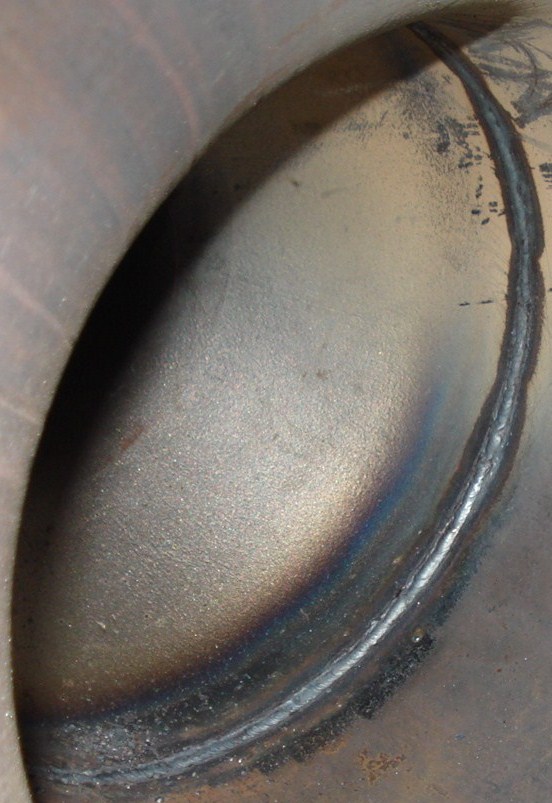

fjsenior moment runnach,i thought i had shown a 6013 root,they were tig,my apologies .i suppose the answer to your question then is i had been doing a lot of hot water pipes, and they were all very light pipe,thats usually tig root,so thats what i had been doing.heres hot water pipe,pain in the ****fj
i can explain the way i go about root filler and cap,but only that there are lots of methods,and mistakes.f/j

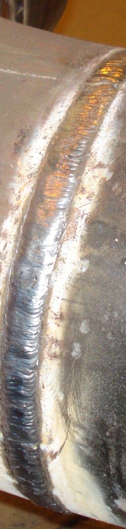

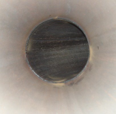

the more i think of it i am convinced a heavier land would benefit you,try 2.5 root gap 2.5 rod on 6010.
no type o puddles,2.5 gap 2.5 rod up to 8 ins with 10. 2.5 rod 2.5 gap up to 6ins 6013.2.5 rod 3.25 gap 6013 on up to 12 ins. f/j![]()
