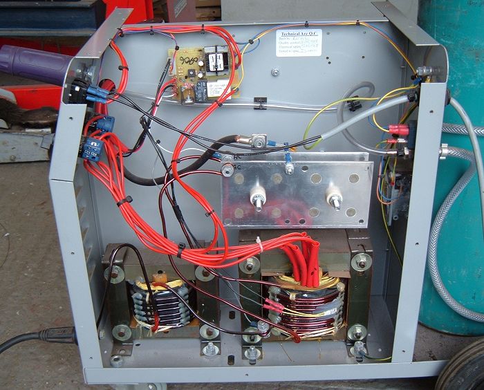

I'm baffled. My little welder is one of the type that adjusts wire speed with voltage setting. It used to be that I could set it to about 5.5 on the dial and weld happily all day on any voltage setting.
It still likes to start off at about 5.5, but after about 2 inchs of welding it prefers to be nearer 5 (making it tricky to weld small pipes), and by the time I've welded around a foot (in distance) it wants to be at about 4 where it settles down and is happy.
My thought was resistance in cable joints, but the thing is only 1 year old, and I've had all the joints apart and back together and no difference. Checked resistance all over the place and there doesn't seem to be a high resistance anywhere.
I'm completely baffled! Is there anything electrical that might cause this sort of thing - or any control measures that might be added to get around them? Or should I keep looking for bad connectors or dry solder joints?
