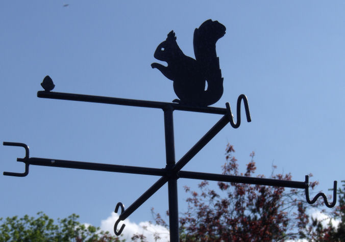

We have a very small garden and the boss wanted a weather vane. This is what I came up with using bits of scrap. Letters are old tent pegs bent to shape. The pivot is a bolt with a point on the end with a tube over the top which is welded to the vane. The squirrel is 2mm plate about 150 mm tall cut with a jigsaw and filed. Its mounted on top of the washing pole and seams to work ok. She is well pleased with it.
