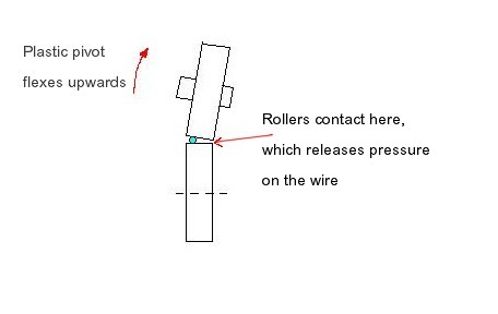

Unfortunately, I discovered this forum after I'd purchased a Cosmo welder - probably would have gone for a different machine if I'd have known about the bad reputation SIP / Cosmo have
Anyway, I have run about half a dozen small reels through it over the last few months without any problems. Then within a couple of days of putting in a large reel, I started to experience problems with the wire feed.
The motor was turning, but the rollers were slipping and not feeding the wire through.
On closer inspection, I could see that the plastic pivot that carriers the idler roller was flexing. This resulted in the rollers being out of true, and losing the grip on the wire.
I came up with a simple solution that stops this from happening. So far, I've run another large reel through without any problems at all - wire feed is much more stable and no signs of slipping.
A couple of photos below to show the simple solution. Hopefully this will be of use to anyone who's suffering these sort of problems with their SIP / Cosmo machine. Probably worth trying before changing to a steel liner?
