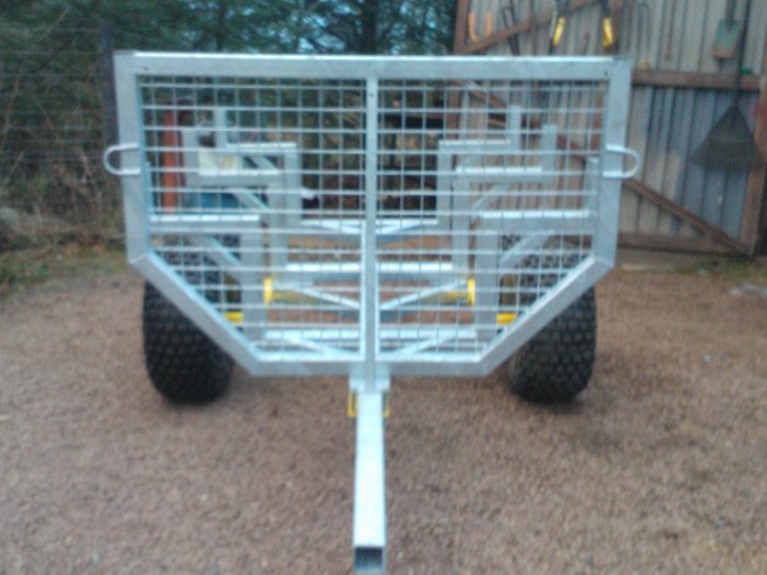

Thought I'd stick up a few photos of my new ATV tandem axle four wheeler trailer for hauling timber
All welded up with my 190Amp mig and galvanised afterwards. The tandem axles are pivoted on 1 1/4 round steel pins through brass bushes with stainless washers either side of the pin and secured with a split pin. I also fitted a 360* swivel hitch for added safety on rough ground and slopes. The top half of the stakes are removable as I'm planning on making up a removable flatbed deck at a later date to make it more useful when not needing to haul timber. The headboard at the front is also adjustable forward and rear to allow for different lengths of timber.
