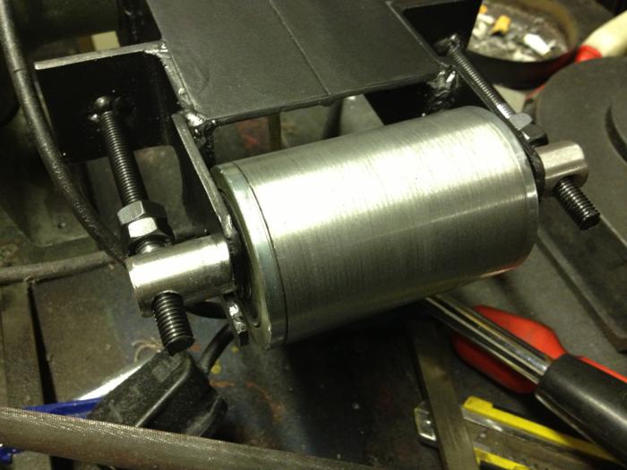

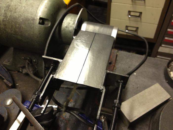

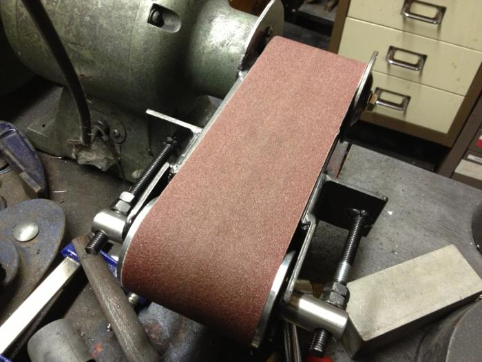

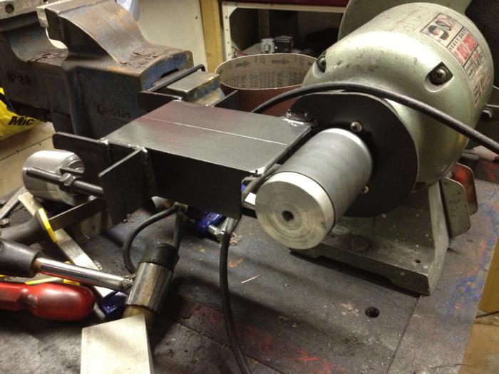

Usefull machine there,well made,I wouldn't be without my home made one I made many years ago, not sure what the flange is for as the band won't fly off if the rollers are crowned, a small but usefull point, a fence above the band is usefull especially if taking ''bonus cuts'' & if made to swivel vertically you can dress to angles etc.
