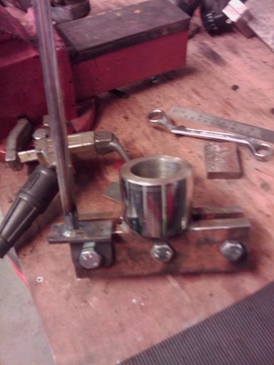

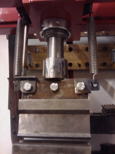

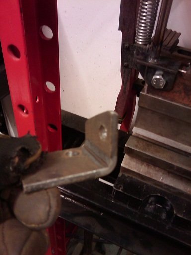

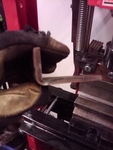

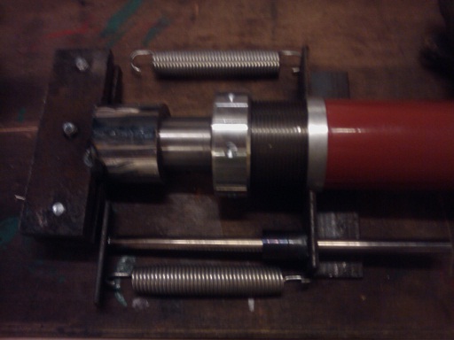

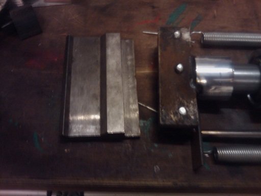

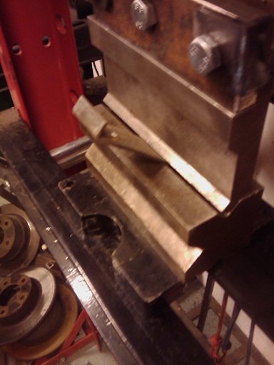

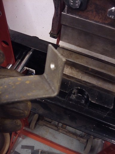

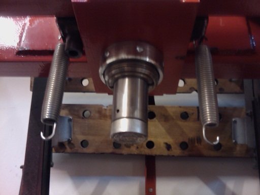

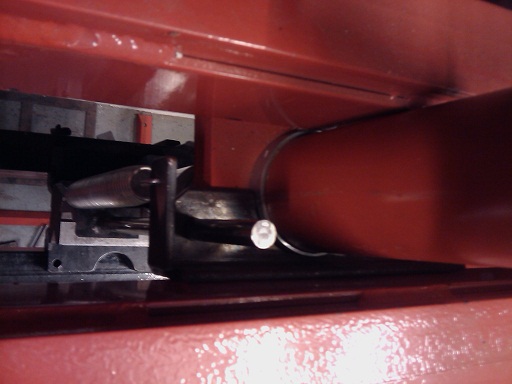

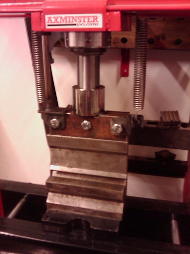

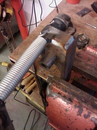

Evening all, following the thread regarding the lack of projects put on the forum I thought I would share this one with you all.
I bought a 20 ton press in January for usual workshop jobs (shifting bearings ect) but I also wanted it to beable to cold bend nice tight corners in steel bar ect for other projects.
The idea was copied from my brother's press hes uses for his fabricating business.
As you can see it does a nice job of 6mm flat bar.
I bought the blade and V block off ebay. Springs from a car boot and the other stuff were from the scrap bin appart from the 4inch chrome bar which off a ram from a scrap yard.
After many hours of cutting, milling, turning and welding it is nearly done. just needs a lick of paint now.
Enjoy
