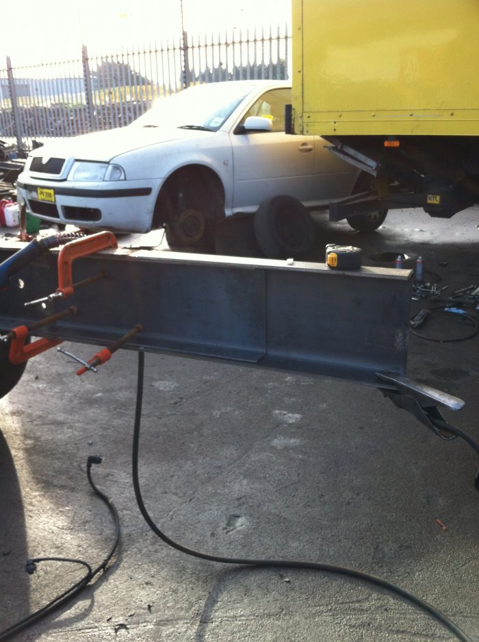

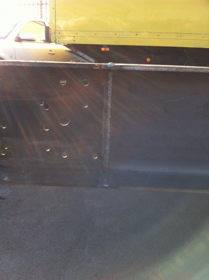

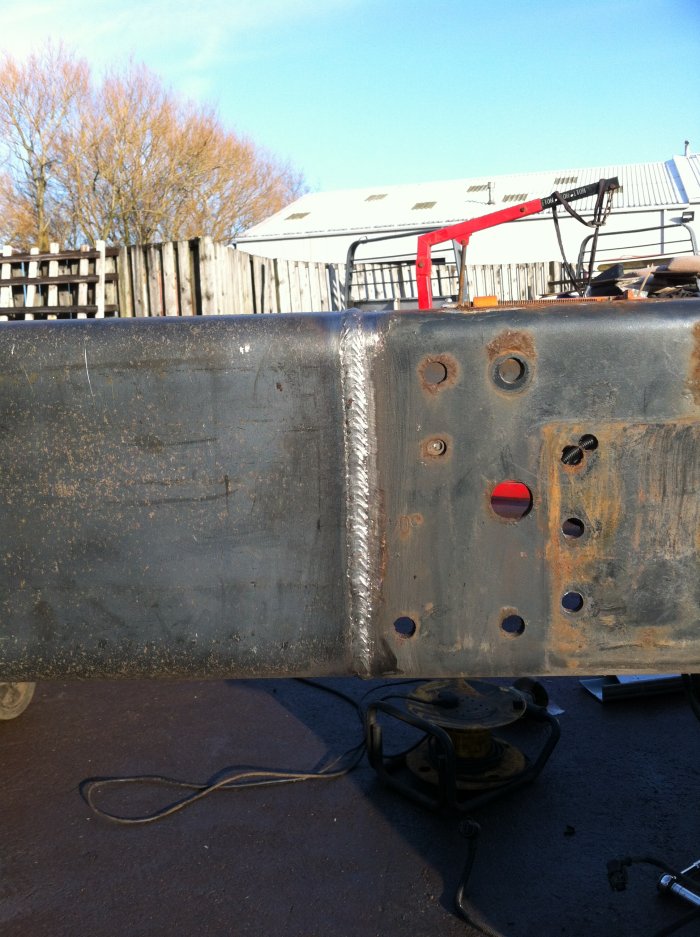

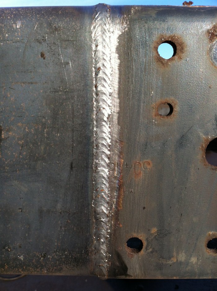

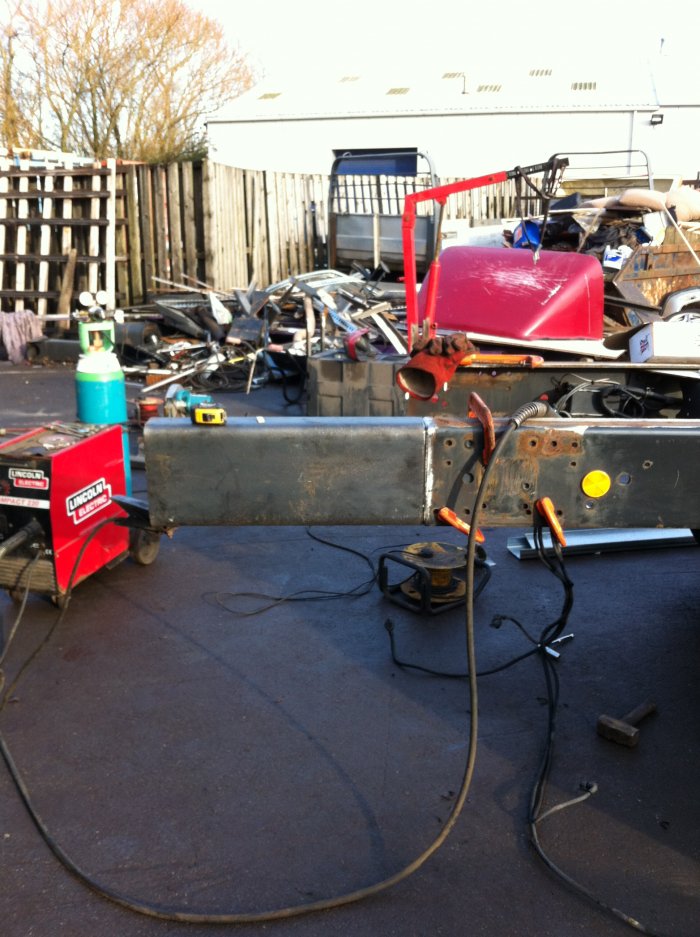

Heres a job i did extending the rear end of a chassis to allow a longer body to be fitted. I used a lot of 'G' clamps and a 6mm thick flitch place to get the new chassis in line with the end of the exsisting chassis. I 'V' grooved the chassis and root welded before cleaning up and capping it. The Flitch plate was bolted in place the old cross member had just enough room to fit in and be fixed behind the flitch.
