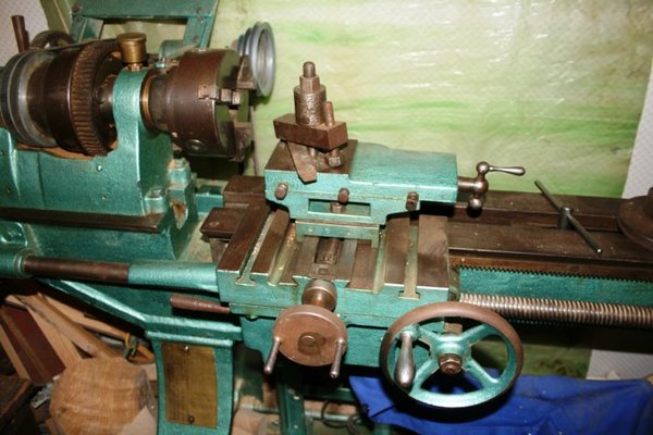

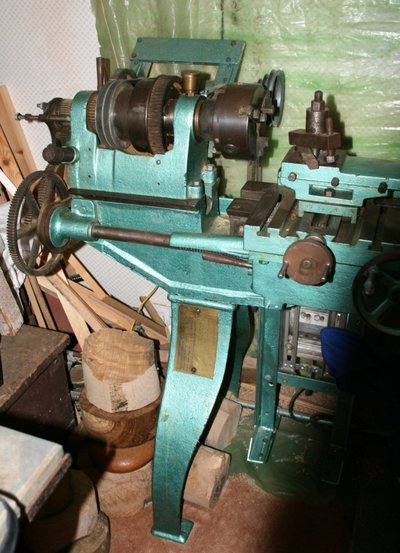

I bought this about 8 years ago on auction. It had no Make or identification plates on it. It was a silver-grey when I bought it and was driven by an overhead belt system.
Gearbox. Original gears with selection of independent wheels that provide a range of screw-cutting sizes and speeds. (Gears not included in photograph) Main shaft of gearbox (11/2 diameter) is threaded to take chuck and/or face plate.
The chuck is a standard 3 jaw reversible 6 1/4” diameter.
Face plate is 5 3/4” diameter predrilled.

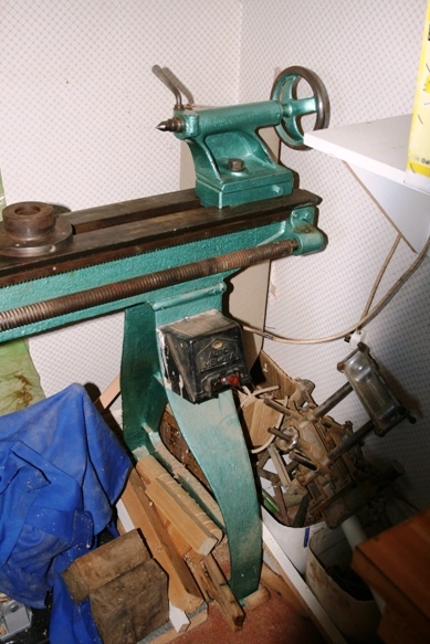

Cast iron tailstock machined to take morse taper for live or dead centres.
Motor - 1Hp single phase. (not on original lathe.) Both motor and layshaft at back of gearbox, each provided with stepped pulleys to provide adjustable speed range.
Lathe bed - Machined cast iron with 36” between centres. (Face of chuck to tail stock centre)
Swing - Distance between centre of main shaft of gearbox and surface of the bed is 6”.
