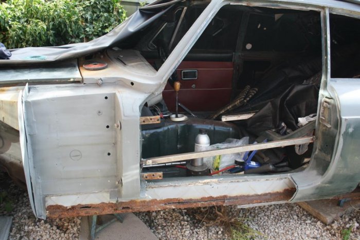

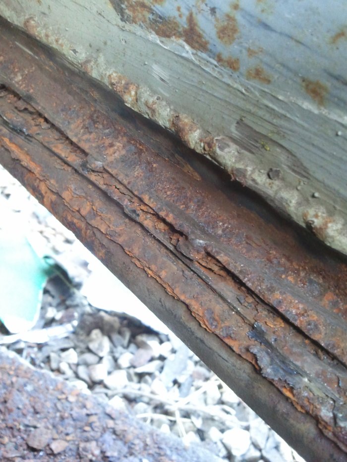

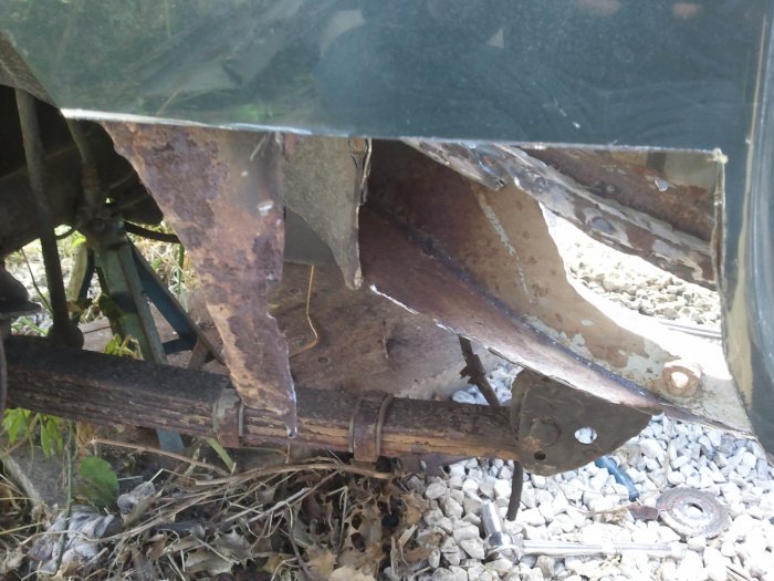

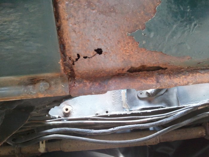

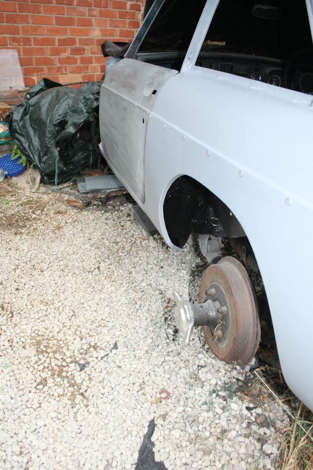

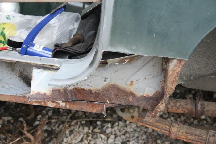

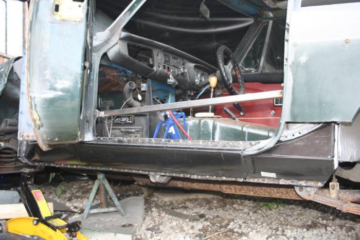

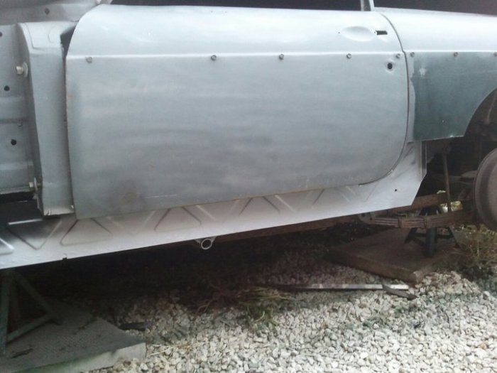

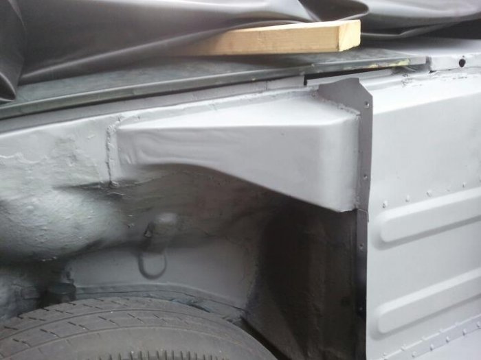

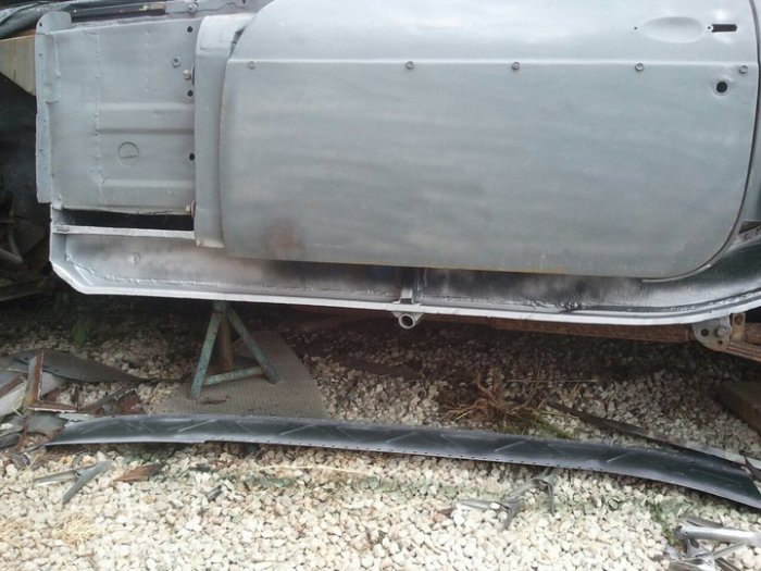

Passenger Side sills, footwell panel/ Splash guard mount, and top box trumpet replacement.

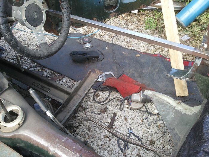

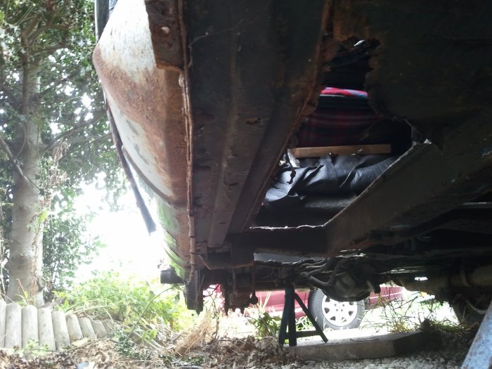

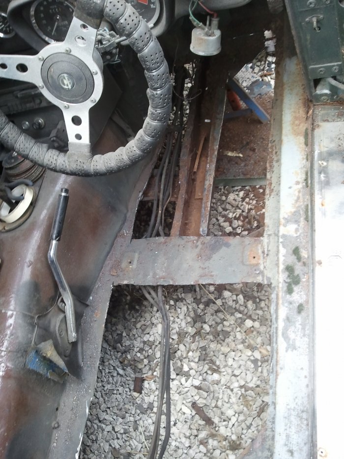

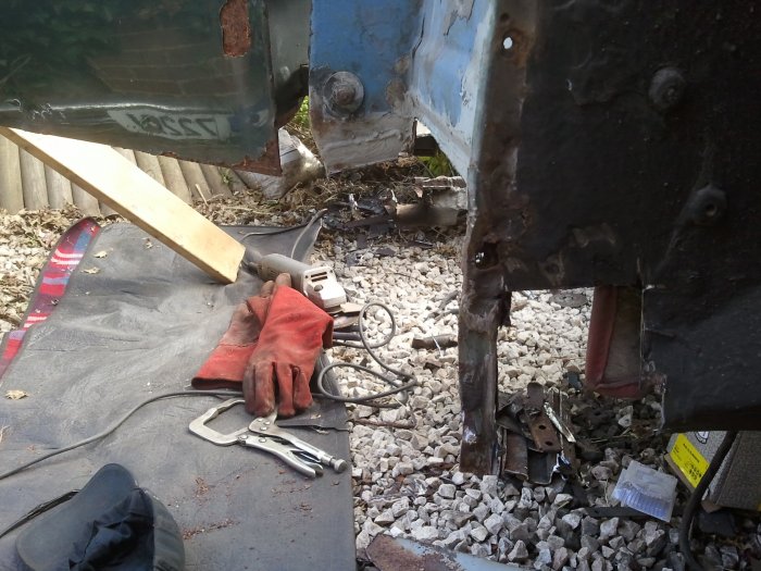

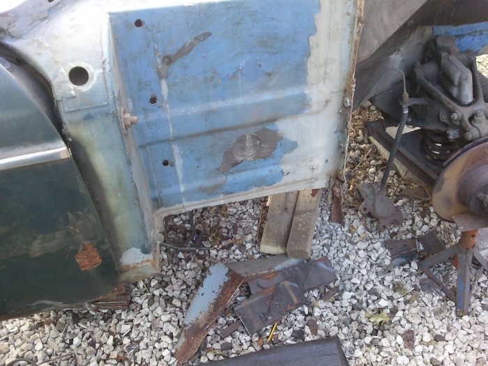

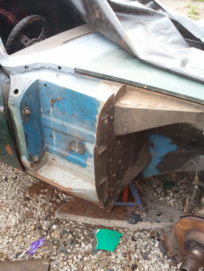

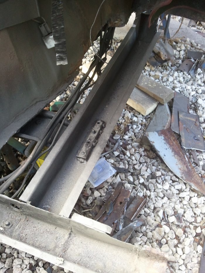

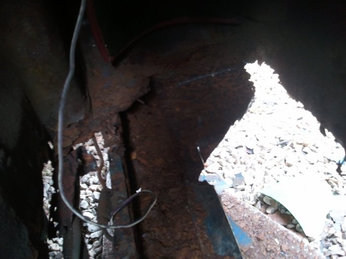

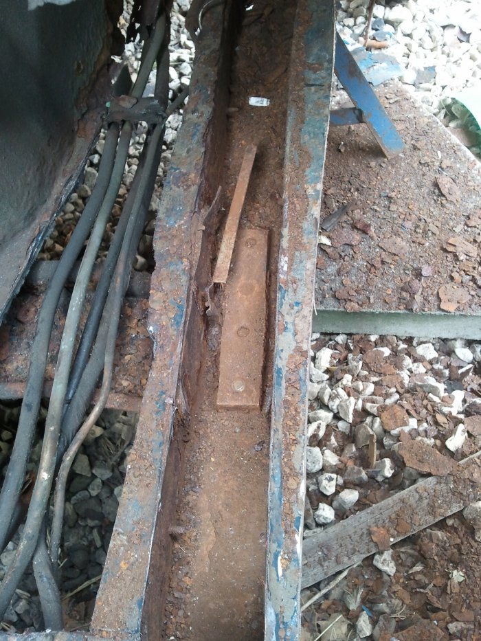

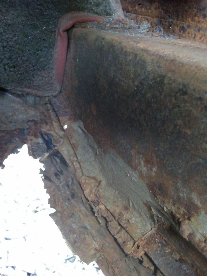

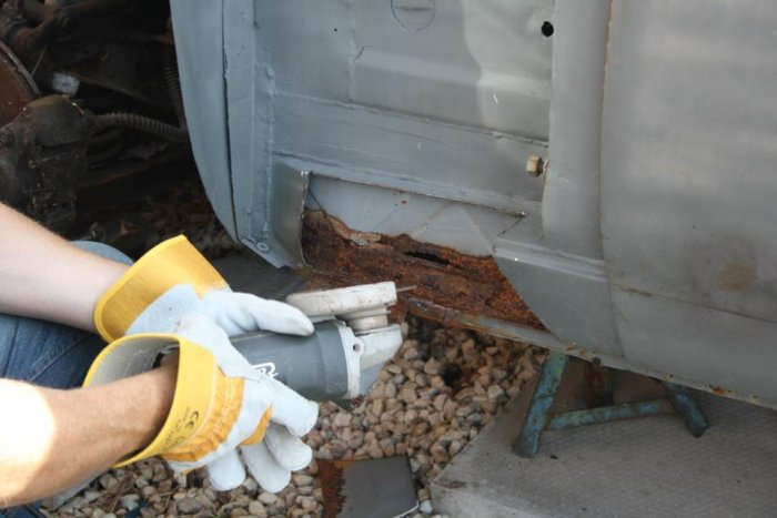

The drivers side will be having a new floor and chassis rail. I have just cut the floor out. Pics to follow.

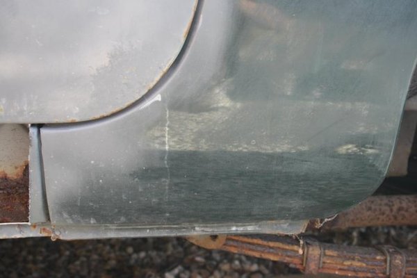

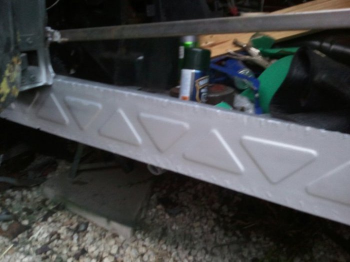

The outer sill panel was a pig as it was spread out. compared to the membrane. But with a workmare, a block of wood, a car jack and a full day wrestling it it went on nicely with a decent door gap
