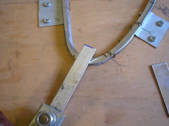

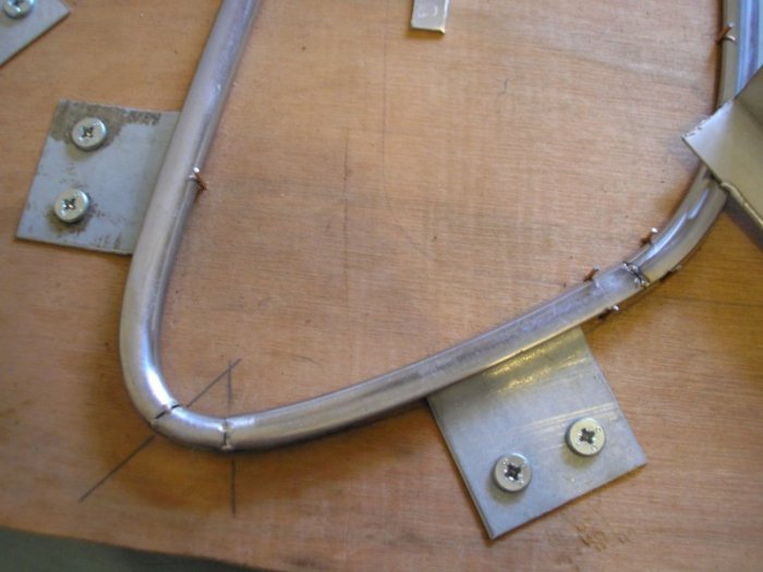

Probably origionally made from 28swg stainless (around 60 years ago) they measured up at ~ 0.35mm...
Can you tell what it is yet? Just one cryptic clue for now... Langy should recognise what i'm doing as he's probably done this job before.
For scale the pins that are bashed in the ply to hold things in alignment are 1.6mm TIG wire. Pulsed @ 175Hz, 18A peak, 11 background, 50% pulse width which was a touch high- could have done with some 0.6mm MIG wire but had to make do with 0.8mm.
