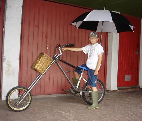

Take 1 Kids Frame (16 Inch Wheel I think) and strip down.
I spent a while (30 Mins) thinking about what to do... The next night after spending some time looking at various websites I pickup the angle grinder and turn the MIG Welder on.
I removed the rear triangle and put on some extensions on the bottom tube. This gives around a 3inch increase on the bottom tube. This increases the lean on the forks (I don't know the differance between Trail, Rake, and so on) Meaning the forks will need a 6 inch lengthening to keep the bottom of the rear triagle level with the ground
I also cut the forks and leant them forward a little to fix the apparent wobble effect some learned builders speak of.. OK I went looking for the maths behind it, but I have the excuse; I want to ridable by my 8 year old tomboy. She's the one that saw a chopper in a shop (piece of trash) and drooled for weeks.
Measuring the changes made give a increase of 10 inches to the current fork length.
My next job is that I need to increase the distance between the pedals and the seat.
I'm thinking I can cut the rear section to the same angle as the top of the rear triangle (must learn the right names) then extend back and a little up (just enough) to clear the rear wheel.
Any thoughts or suggestions will be welcome. I'm trying to make a reasonable but obvious chopper for my bike mad daughter. So while I want chopperness I also want it rideable.
I'm also looking at my wife bike that she's not ridden for 4 years.......... Recumbent parts.
This is more fun then the kit car chassis I built. No measuring, just using my eye.. If it doesnt' ride straight I'll blame my daughter. The car chassis got stupid at then end. 1mm accuracy wasn't good enough.
