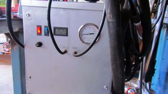

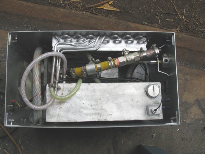

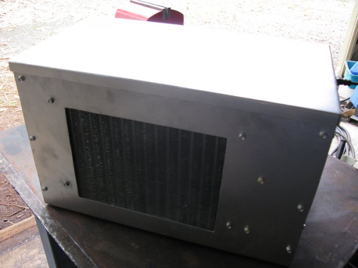

Here is a TIG cooler I made out of bits and pieces, I cut up an old greenhouse water heater for the aluminium sheeting to make the case and the fluid container as I no longer used the heater. Made some hose fittings out of aluminium and brass rod on the lathe, pulled apart an old discarded air conditioner for the fan and the radiator.
New parts were an electric motor driven low volume, high pressure pump, a pressure gauge, 2 switches, one for the fan and one for the pump, a fuse holder, a cheap aquarium digital temp gauge, assorted S/S ring clamps and a ball tap to adjust the flow pressure. All up it cost about $100 to build.

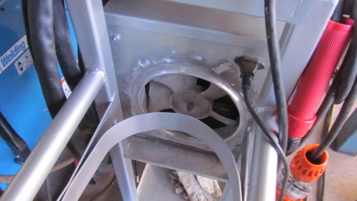

The tap is adjusted to let through about 3.5lts/minute at 26PSI and the holding tank has about 17lts of fluid to which I added coolant to stop corrosion. The only complaint is that the pump is a bit noisy but at least I won’t forget to switch it off. Only modification after I built and painted it was to add a fan shroud, which then forced about 3 times the amount of air through the radiator than before it had it.
