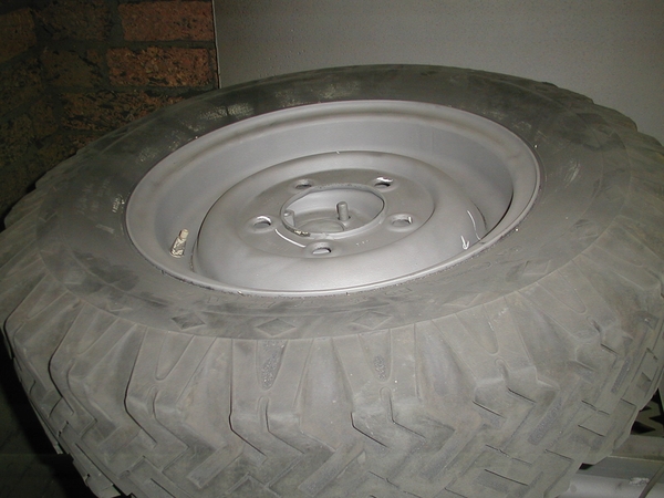

Just got some Landrover wheels in to blast, and they're too heavy to manhandle easily on my bench, so I knocked this up from scrap lying around in my yard.

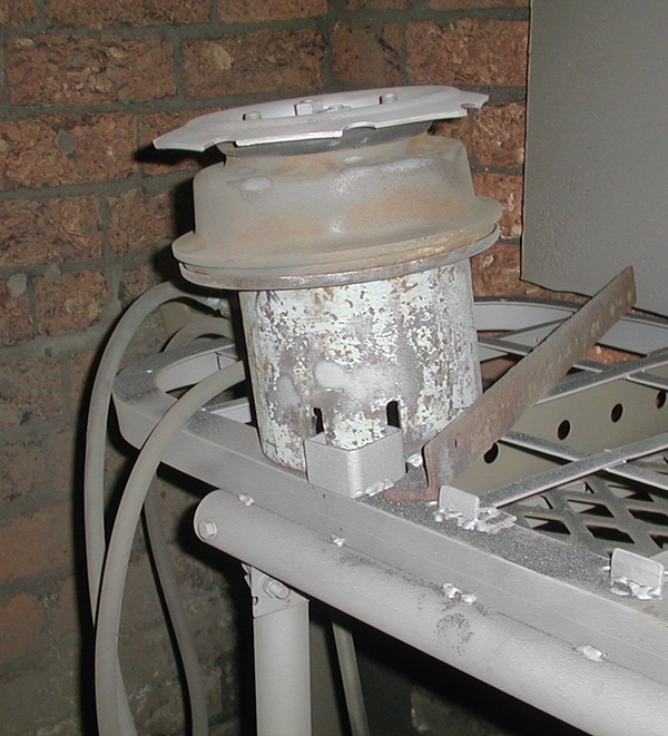

This is a Rover Metro rear hub asssembly with the backplate welded to a section cut out of a CO2 bottle. The two slots allow it to clip on to one of the lugs welded to my table. The piece of angle iron is welded on to the bottle and serves to spread the weight accross the table :-
The centre cut out of a Metro wheel fits nicely into the landrover wheel :-
I've also used this to blast small parts, using magnets to hold them in place.
