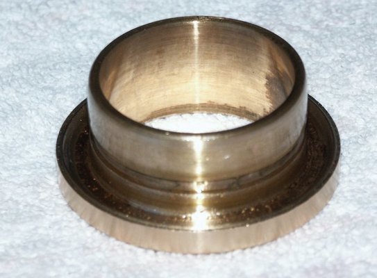

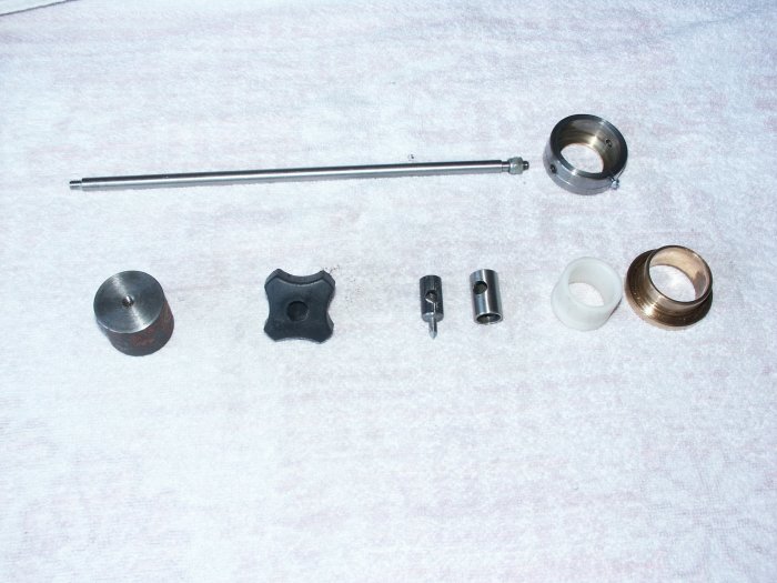

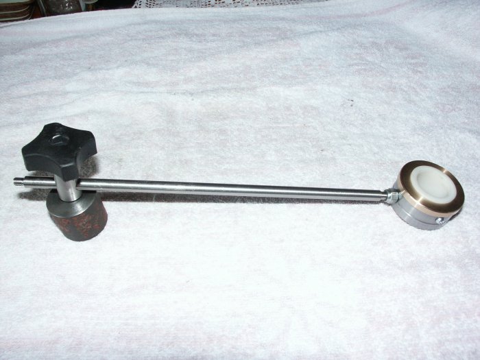

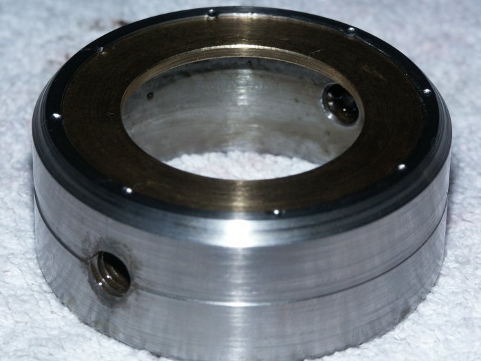

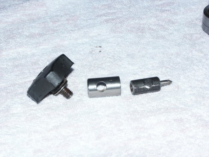

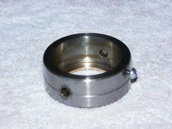

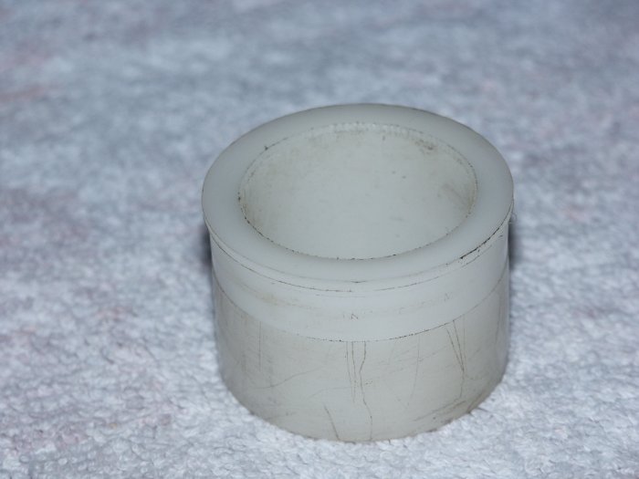

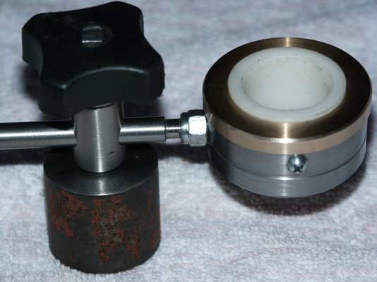

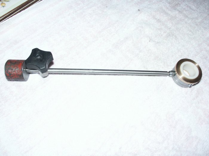

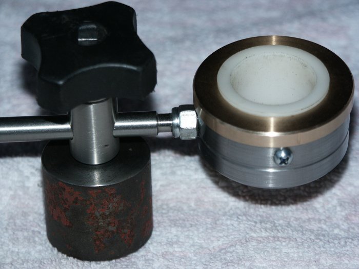

Hello All.
recently bought a Hypertherm Powermax 45. and thought a decent circle cutter would be nice to go with it. having previously just used anything that could be cobbled together to do the job, No cost involved,all made from virtual scrap ends,The ugly looking lump on the end is a nice strong magnet that can be used as the pivot point on ferrous metal and screws onto the trammel rod end for storage,Didn't take very long with the little Boxford and works a treat, White nylon bush in the centre will protect the torch and can be changed to accommodate different diameters,
