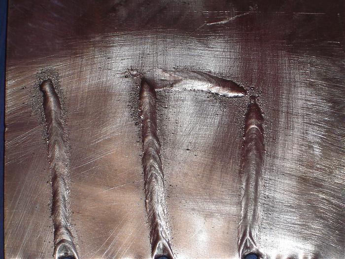

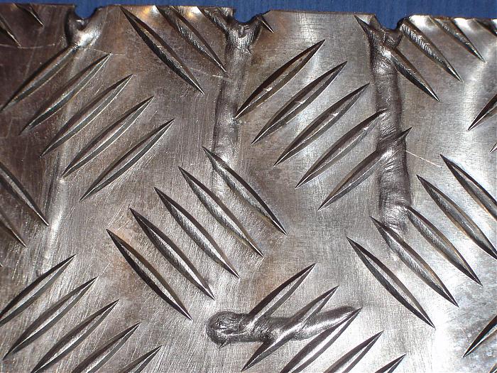

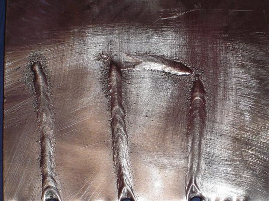

Still faffing about with Portamig on Pureshield and a little spool of ally wire which I wound on to a big spool. The machine only seems to get going on powerfull settings and highish wire speeds.
Standard liner and about 5psi of gas. This is 3mm plate. The pattern side is the penetration. At least Ihave found out that it is possible to get some kind of result.
