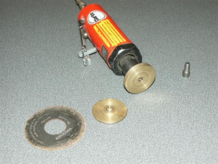

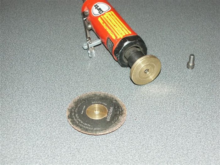

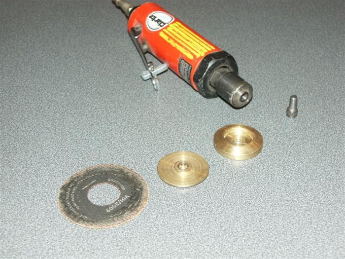

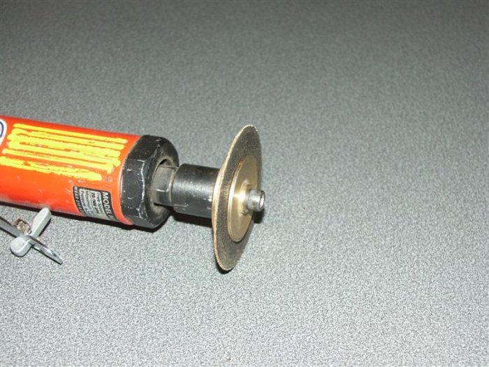

Been meaning to post this up for some time. The discs available for the Inline Air cut off tool are expensive and too thick, causing the tool to slow down.
Been the tight Yorkshire man I am I save the cut off discs used in my 4" grinder.
I machined up a collet set to use the remaining disc up. These were machined out of Brass, but that's only as I had a bit laying about.
The pictures speak for themselves. So I'll leave it at that
