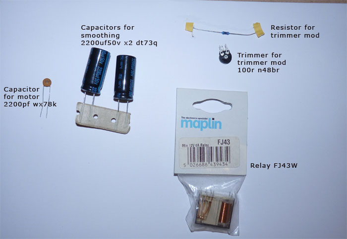

First the components you will need.
As well as these you will also need a soldering iron, solder, wire/cable, wire spade connectors and some veroboard ( to mount the components to).

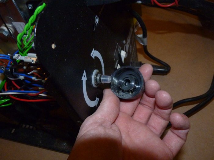

First remove the cover, lots of small self tappers.
Then the wire feed speed knob, which just pulls off.

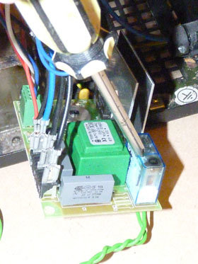

Undo the bolt on the end which will release the Printed circuit board (PCB).

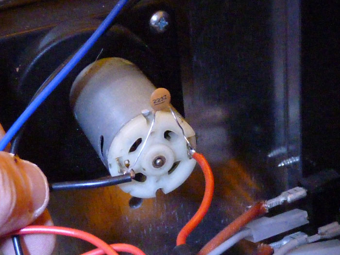

solder the motor capacitor across the motor.

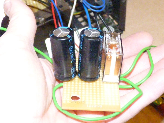

Making your own circuit board.

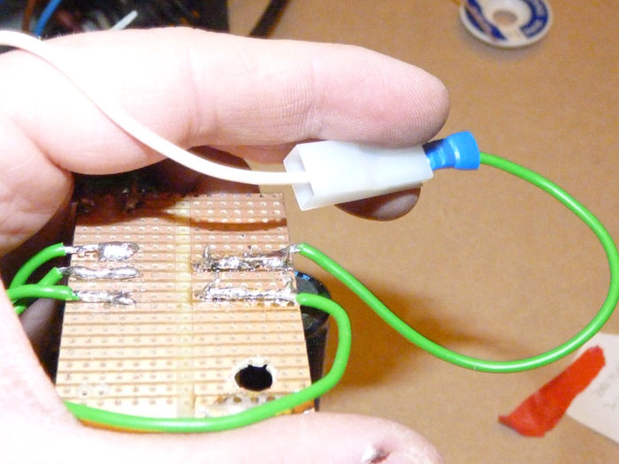

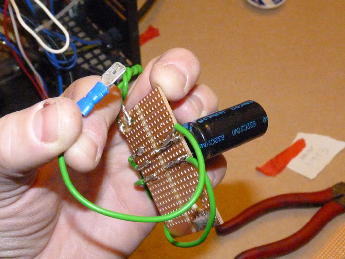

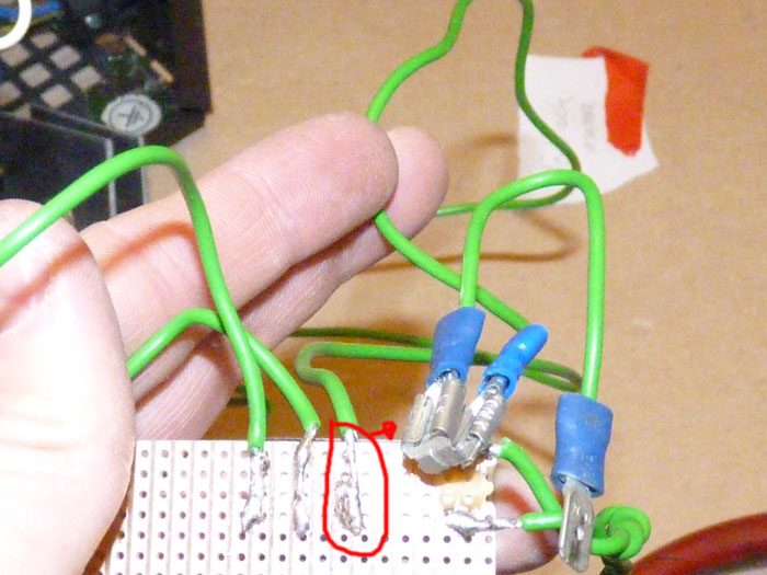

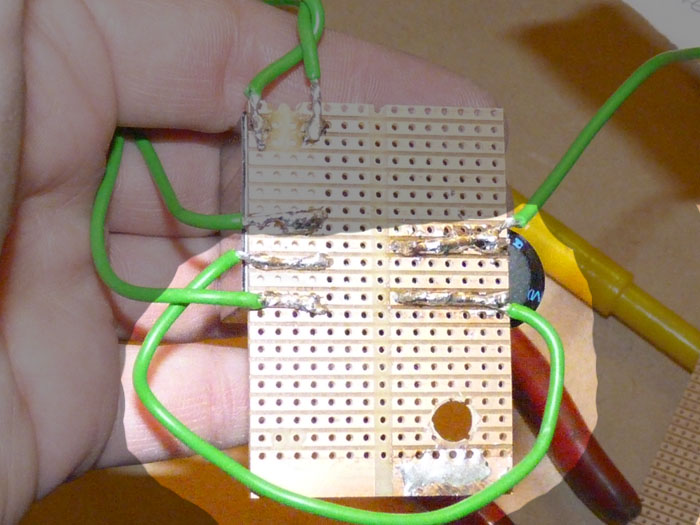

Using the Veroboard and its copper strips solder the two big smoothing capacitors in parallel. Place them a couple of millimetres higher than the board. They have a plus and a minus side so get this right, mine had a strip of minuses running down one side.
Image 5
Then add the wires which you will use to splice into the existing machine. I use plenty on length for all these then chop it down later. I also soldered the wires direct on to both pins of the capacitors as I wasn’t sure of the rating of Veroboard, but have since learnt it would be fine with out.
So now you have two capacitors in parallel with two lengths of wire leading from them.

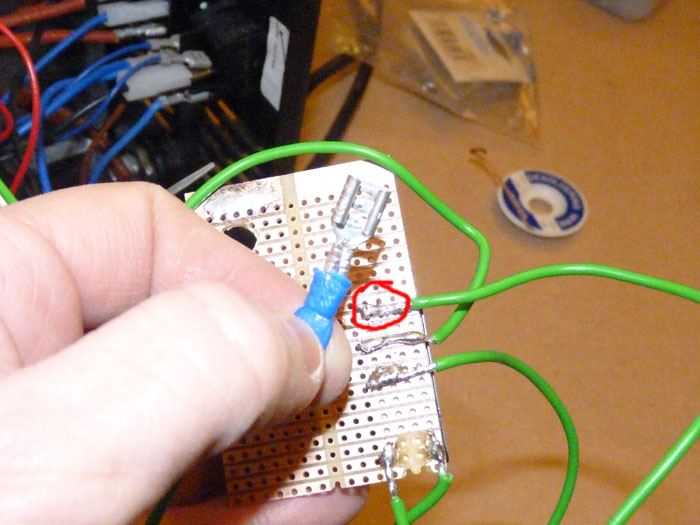

The relay.

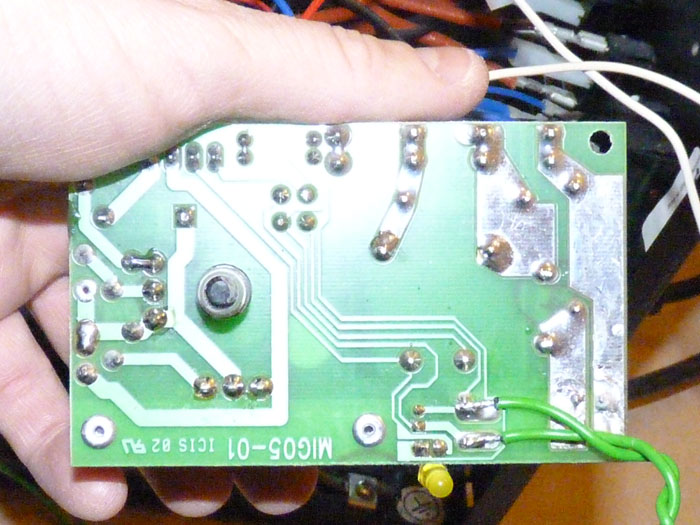

For this you will take a feed from the existing PCB relay.
Solder two lengths of cable from the connections shown below.

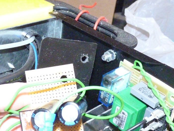

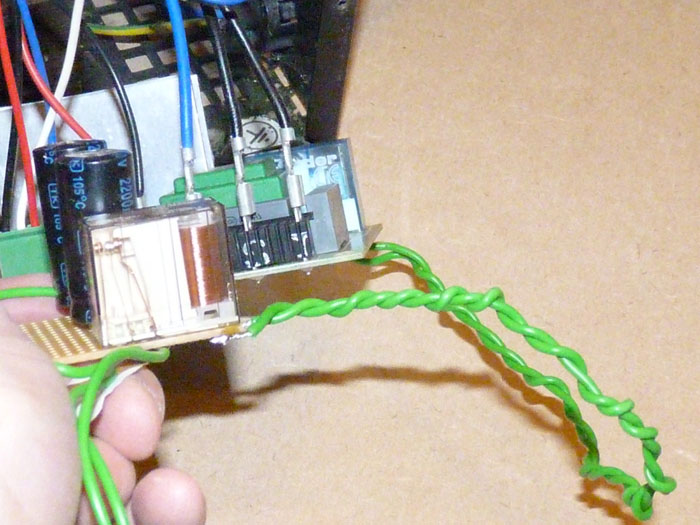

Now on the same veroboard mount the new Relay FJ43W See image 4, but electrically separate from the capacitors, so make sure the coppers on the veroboard is broken between the two.
Take the two wires from the existing relay to the new one, attached on the coil side connectors. It doesn't matter which way round the wires go.
Take the positive (+) wire from the capacitors and attach to the relay as the below image
Now solder two more lengths of cable to the remaining two connections

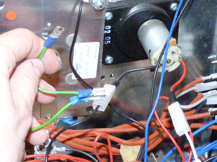

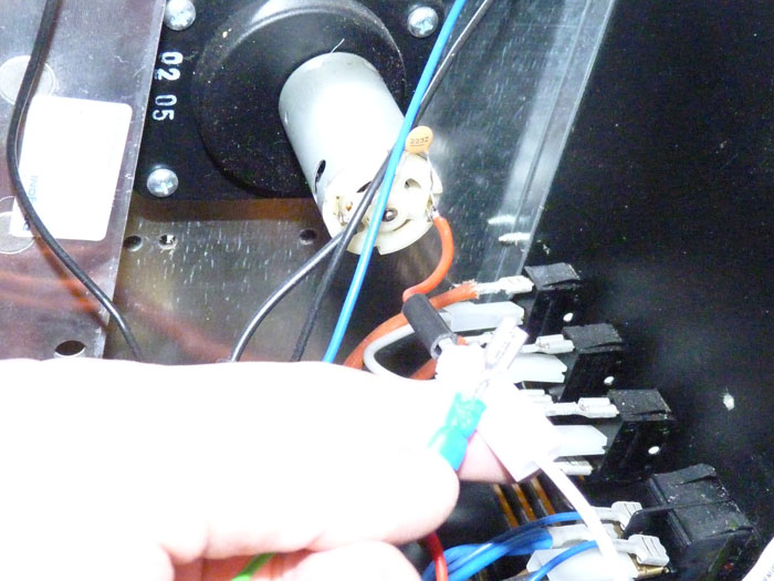

Splicing into the existing system
You should now have 3 loose wires coming from the new PCB.

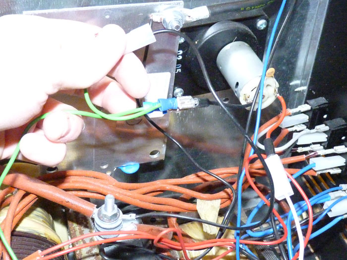

Disconnect the white wire which is attached to the red cable of the wire feed motor and connect it to the cable from the capacitor on the new PCB
Image 10
Take the end wire from the new Relay add a connector, attach it to the red wire from the motor.
disconnect the connector from black wire from the feed motor.
Attach a double spade connector to the last free wire from the relay on the new PCB .
Connect the black wire from the wire feed motor to double connector, make up a short length of cable and attach to the loose wire which had feed the wire feed motor.

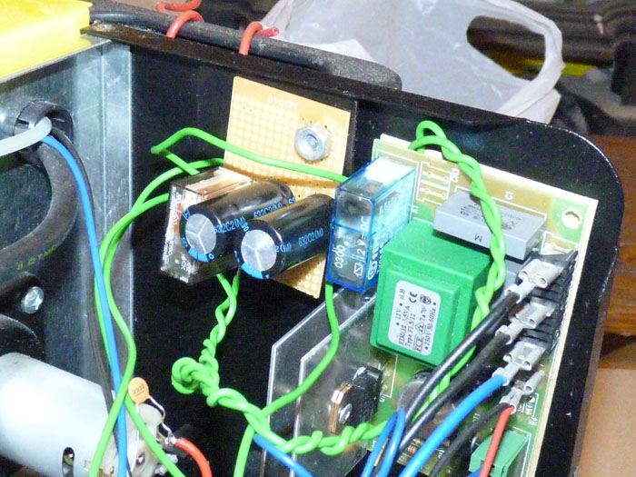

mounting the PCB
As the process so far is completely reversible I didn't want to drill holes ect so I attached my new PCB to the handle bolt. As below
Don’t forget to insulate the board from the case.
