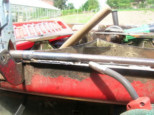

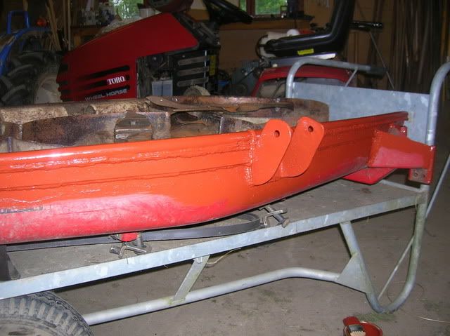

I begain removed the deck from this wheel hoarse as there were complaints of funny noises, blunt blades etc so I took a look.
My oh my what a mess.. lets have a look whats wrong with it...
Well for a start its got rust holes, rust, buckeled wheel, blunt blades....
So, kit into the back of the tractor.. hey, my very first mobile job!
Loose seperation walls, this is very dangerous, if it bends into the blades.. metal shrapnel anyone?
So lets get to work.. after a gooood clean out with a wire brush and airline, then ground weld spots, this were getting ready for beating into place (litterly!) and then welding and re-enforcing
