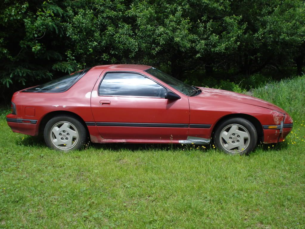

I am fairly new to welding and have never welded on a vehicle before but I can get by with my mig welding. I never took a class, learned how at a job I had.
I have a 1986 mazda rx7 which is a unibody car. I am having outer rocker panels made as they need to be replaced and the rear section of the inner rocker/sill is needing a small patch on both sides of the car. I am using a friends mig welder to do this myself. I have been reading on this site and have found lots of useful info so heres my plan so far:
-weld a peice of tube/pipe between the bottom of the door jam to help keep structure flex down and door gaps in check.
-drill some holes in new rocker for plug welding on the pinch weld on the bottom of the car (planning on welding that seem on the pinch weld as well after)
-doing a butt weld for the top of the outer rocker. having the rocker made so it goes up to the edge of the door. tacking it and stitch welding, leaving plenty of time to cool down and reduce distortion.
-with old rocker off, wire brushing and using some rust converter on the inside to get rid of most rust inside. then spraying weld through primer in there and on the new panel before welding.
now, I was going to cut the old rocker at the angle of the pinch weld and leave that little section on the pinch weld there so I don't have to deal with the spot welds. is that a good approach since I am seem welding and plug welding on the pinch weld anyway? I only have access to a cutting wheel to get the outer rocker off. any tips you guys can give and advice on my plan?
