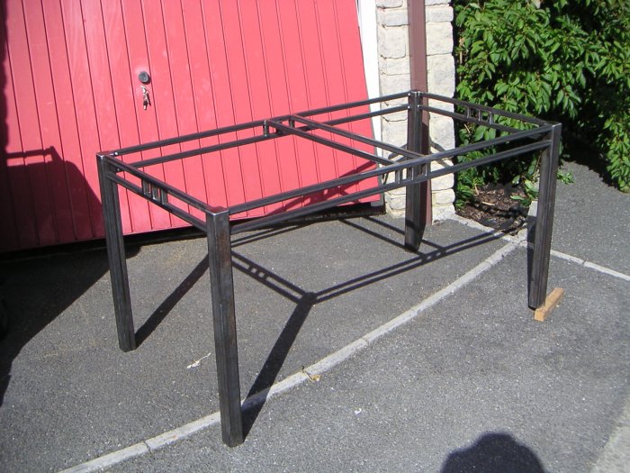

Went to get a pine table and chairs a short while ago.....
Came back with something else.... a black patterned glass table top.
Infact i think, its supposed to be a desk, but ideal size for a table top.
Supposed to be used with trestles, i didnt like that idea, decided to make a proper base frame for it, to match the chairs we bought aswell.
3 hours work this afternoon did it good. Just need to go and see my powdercoating man
About 10m of 20x20x2 shs, and 3m of 50x50x3shs.

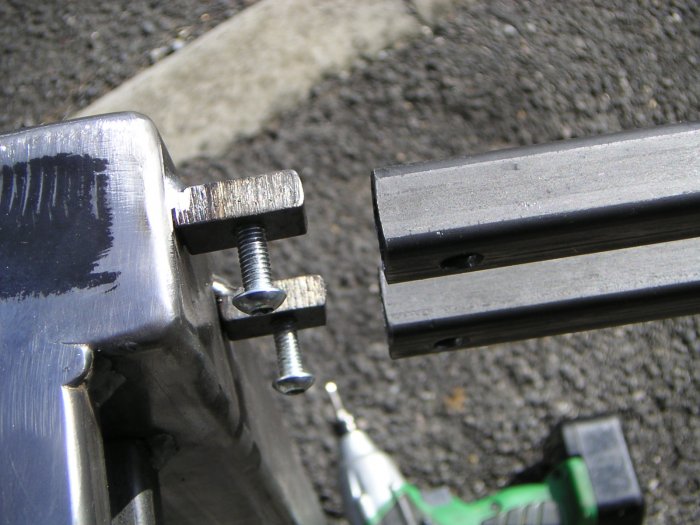

I was tempted to weld it up as one, but decided not to, made up as 2 end frames and side/top frame.
I will update once its all together.

but if you put that leg near a wall the bit of wood shouldn't be too obvious
