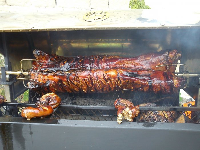

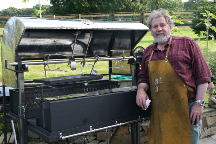

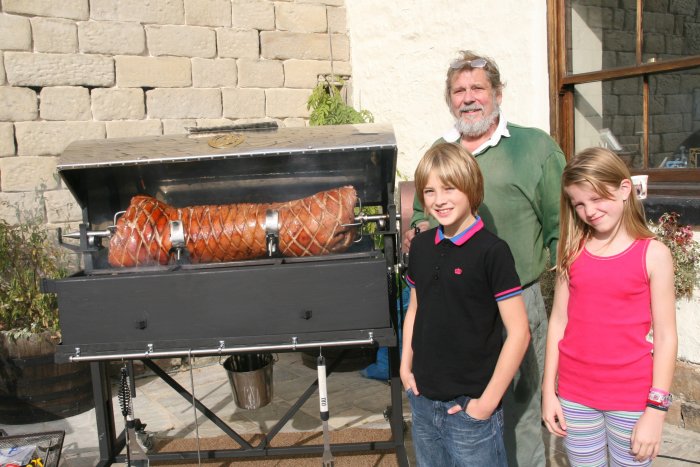

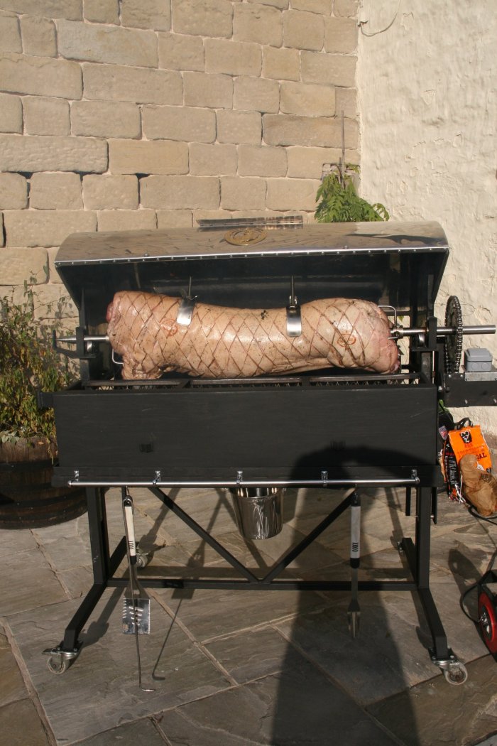

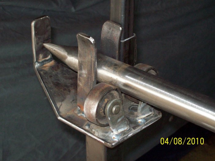

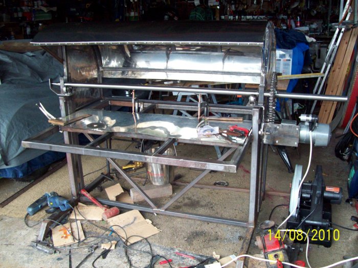

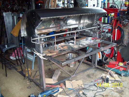

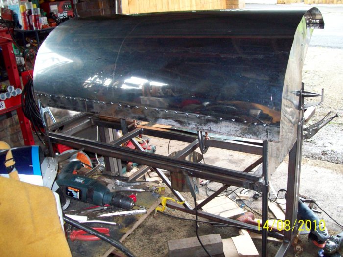

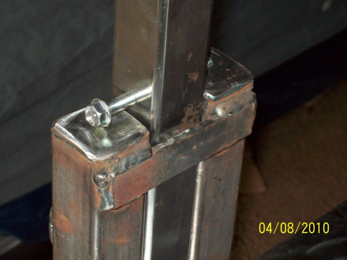

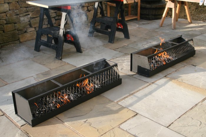

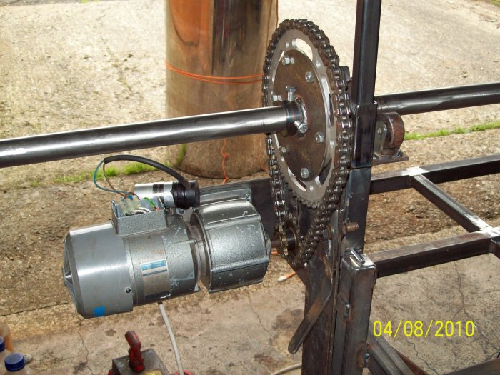

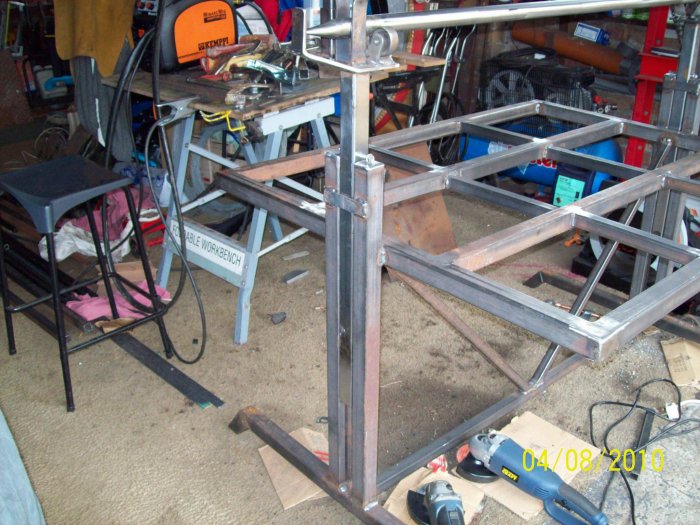

Hi, Everyone,
Some of you may remember I was about to start this project for my daughters 40th B'day celebration,Well after putting my thinking cap on came up with this design, And it worked perfectly,took nearly seven hours to cook the 50+ kilo organically raised pig.Not a bad result for someone thats only cooked sausage and chips before,Total out lay was about £130-00 everything else was donated by family,friends and enybody that even remotely owed me a favour,Motor and gearbox are heavy duty Parvalux donated by my brother-in-law giving a final drive of 6.5 rpm then further reduced to 2 rpm via a couple of moto-cross sprockets and 520 chain, mirror stainless is cladding from one of my sons road tankers,Free logs from son-in-law's fallen trees, Enjoy.
If you have any questions ask away,
Best regards Gordon,
