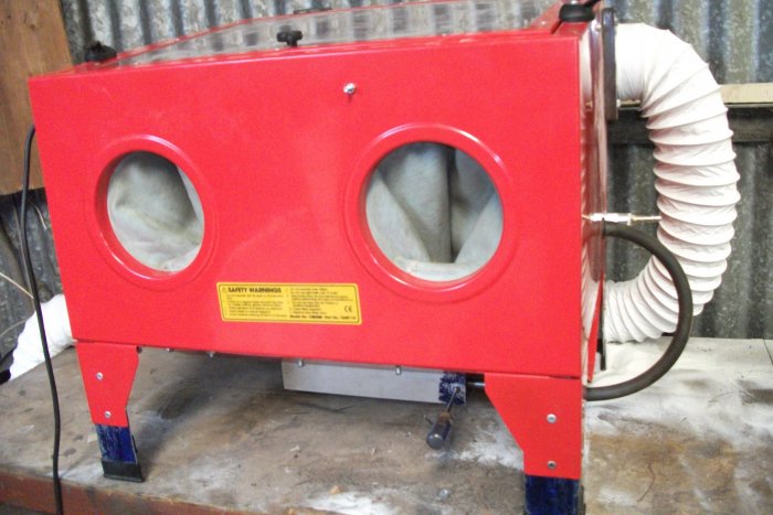

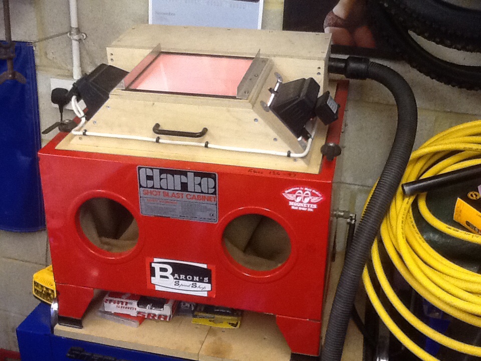

i bought a small blast cabinet just for beadblasting small parts and tools as i allready have larger cabinet .i set it up and started using it expecting good results
i soon found out it was crap

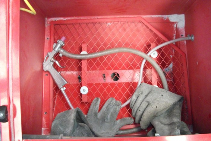

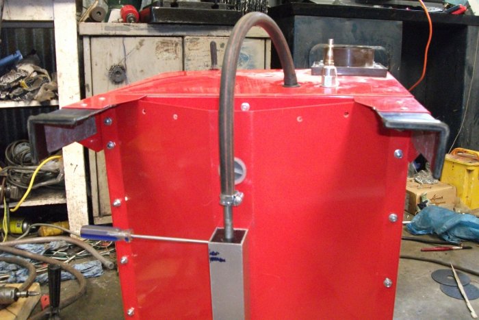

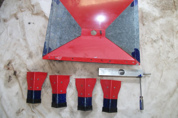

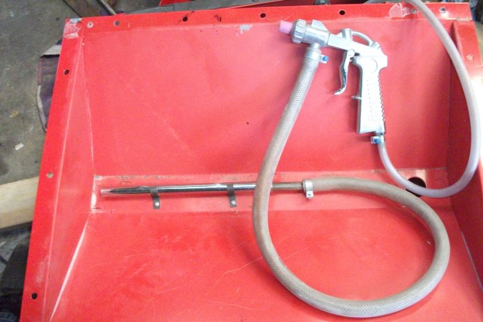

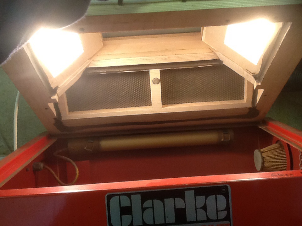

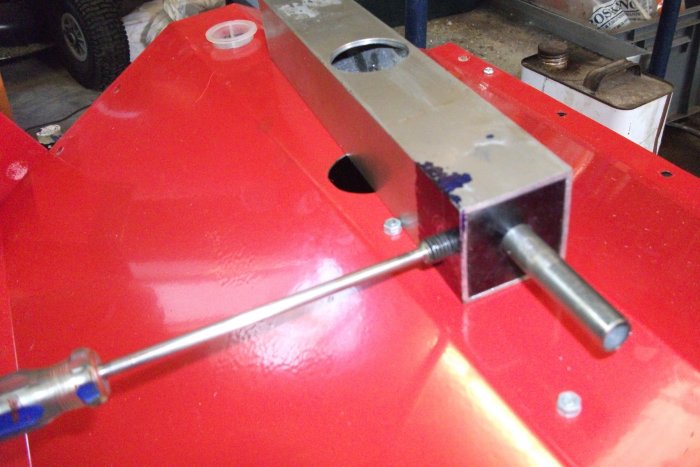

the hopper holding the media is only tapered down 2 sides the full length of cabiet .the pickup pipe sits in the bottom sucks the media away and it heaps up at other end of cabinet and sucks dry. when it manages to work the gun pulses trying to pick up more than the gun can handle .so decided to improve it by taking out the picup pipe making some side plates sloping to the center drill a hole so the media can fall through into into a colection box. an adjustable pickup pipe is mounted in from the side which alows air as well as media to be drawn up pipe through the gun which stops the pulsing .its now at a constant rate of flow. the legs had to be extended to fit box underneath .the small filter in the cabinet is no use at all that was replaced by cutting a 4 inch hole in side of the case a mesh filterplate and 4 inch duct fitted. when blasting the media is blown up from hopper making it dificult to see that was overcome by fitting a rubber mat on the mesh base leaving 2 inch short round the edges for media to fall back and refill .only one light fitted at the back so i fitted one at the front as well . the cabinet works well now
i wouldnt realy recomend anyone buying one unless u just intend to clean real small parts with the modifications .there larger cabinets are half reasonable but still suffer the bad pickup pipe .but can be altered . heres a few pictures of the mods nothing to complicated
