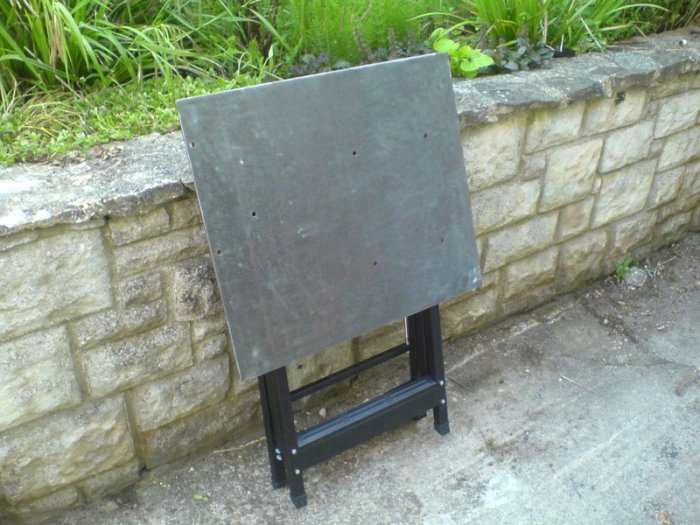

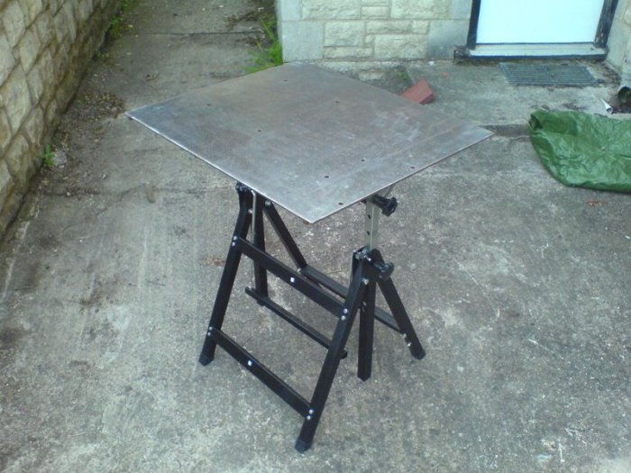

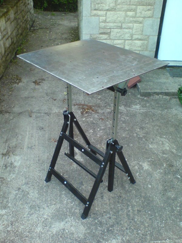

I just got myself a nice TIG welder on Ebay and realised I didn't actually have anywhere to do my welding, the delicate "Tiggy" stuff at least, I've always ended up arc welding on the floor in the past.
I had a steel plate that I got for free an age ago and combined this with the frame from a cheap workmate clone from B&Q (approx £22). I just dumped the original top and welded some angle to the bottom of the plate using my "Aldi special" arc welder so I could bolt it in place.
It is pretty handy, adjustable height, tiltable and it folds up, very stable too considering. May add some holes or slots for bolting stuff to it.
Pictures attached I hope.
