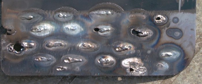

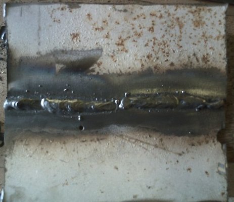

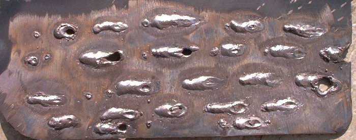

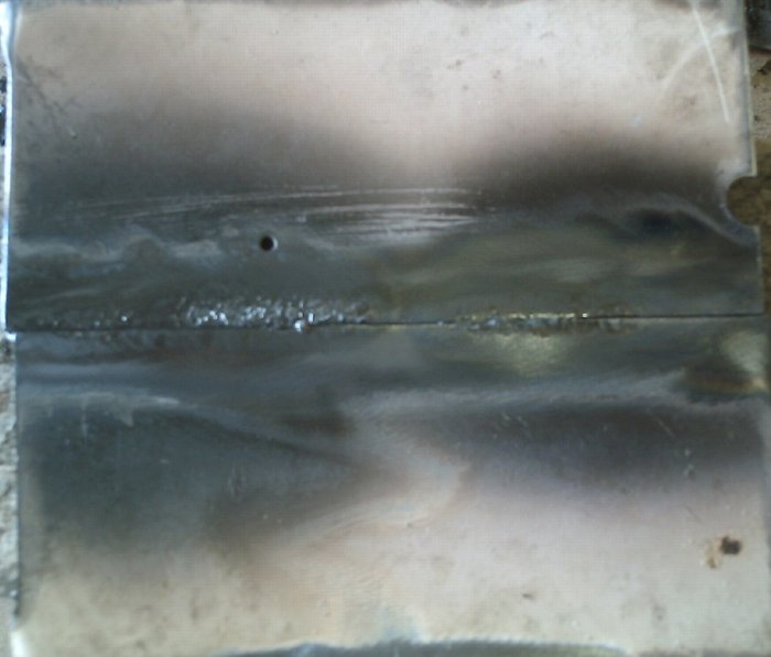

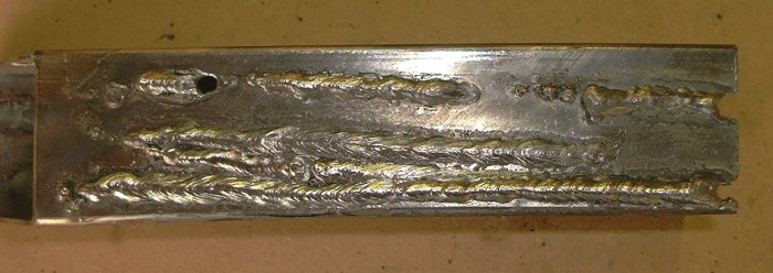

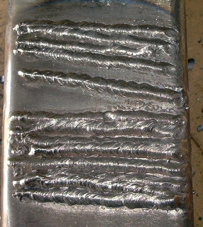

A R-Tech TIG160 in MMA mode [SMAW mode ] my first tries at stick welding with it.

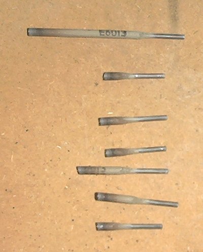

Rods PARWELD 2.4mm on 3mm piece of box m/s weld current around 100 amps ?.
First the 7 dead soldiers.

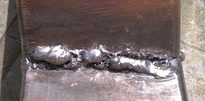

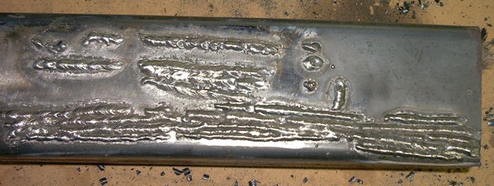

General view of welds I started welding top left and worked across then down one and same again , they were very easy to start [ helped by the welder I suspect ] with minimum sticking but boy do they disappear fast
Close up left and right.
In the bottom right hand corner I did not clean off the mill scale and the rods just kept on welding , I have run a wire brush over the welds to clean then after tapping the slag off [ it came off quite easy for most of the welds.]
First problem the stool I had was to low and it put my face next to the end of the rod so it was then awkward to hold it , so I tried standing then the table was to low to brace myself on so I could not hold the position very long [ wrong side of 50
]. If I was comfortable for a short while that it meant I was unable to compensate for the rod shortening , I have a good DVD of how to stick weld and whilst it shows someone sat at a table and the end of the rod when welding it does not show the pose used ?
Second was I had trouble with the helmet [ cheap ebay one [ will be changed soon ]] I have a light directly above me and in some positions it reflected on the inside of the helmet very distracting. Also I seemed to be able to see the arc illuminate my clothing sometimes below the bottom of the helmet , I have found a adjustment on the strap and think my face was to far out of the helmet so hopefully that is fixed [ there is no light bleeding in around the lense ].
Also how do I see what amps the display on the welder is showing when I am concentrating on the arc ?
So comments please , certainly plenty to improve on !
regards Paul
