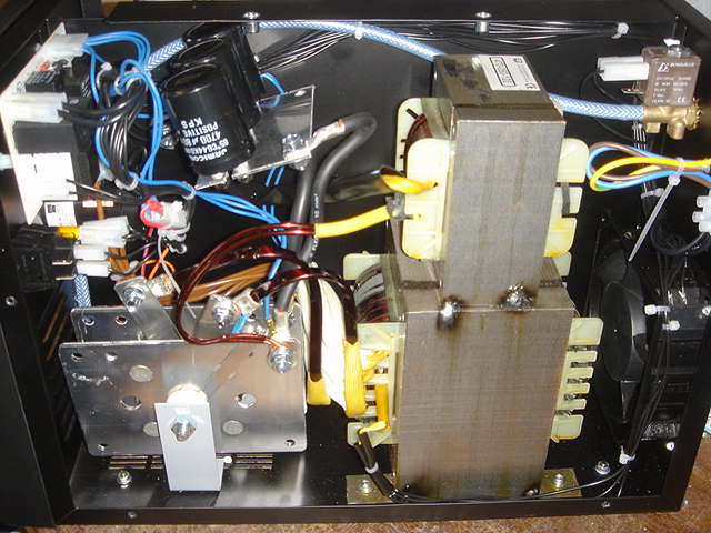

First impressions taking it out of the box was that it was a heavy little sod! so must have plenty of guts. Took the side case off & had a look inside...
Copper wound main transformer, large choke transfomer & 3 smoothing capacitors that should all lead to an excellent arc.

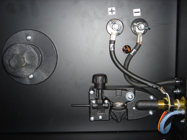

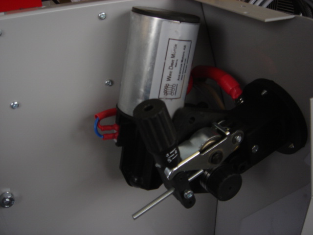

Oh no! a horrible plastic wire feed. To be honest, you have to spend £4-£500+ in the UK to get a really decent quality wire feed assembly, and the model used is one of the better, more reliable ones; I was hoping for something more substantial though!

When I cranked it up toward the top settings the arc quality seemed to deteriorate quite a bit, with increased spatter, but I think this was just down to the small wire feed motor trying to keep up with the increased feed-rate needed for the extra power, as the end results were fine.
