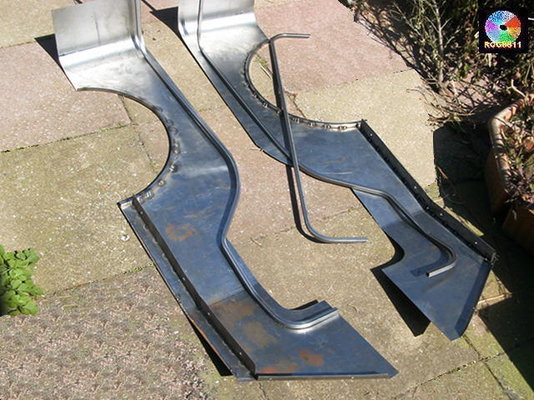

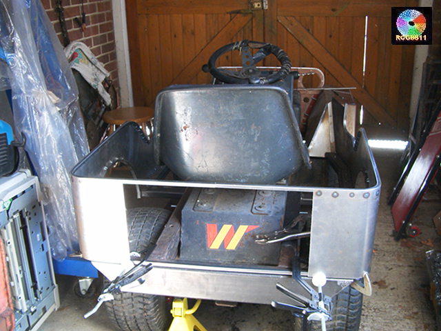

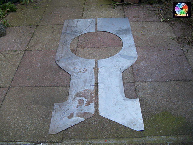

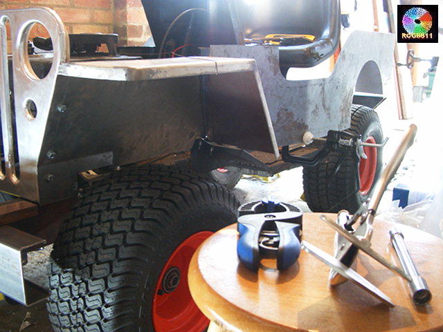

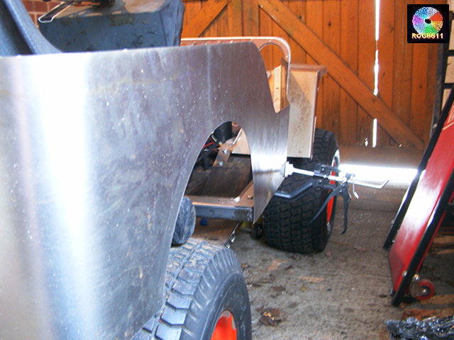

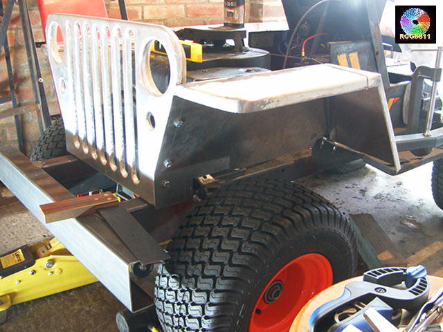

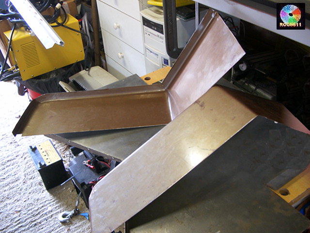

It is a bit early for this but I am so pleased with the way it is looking I thought I would share it here first!

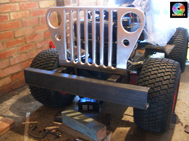

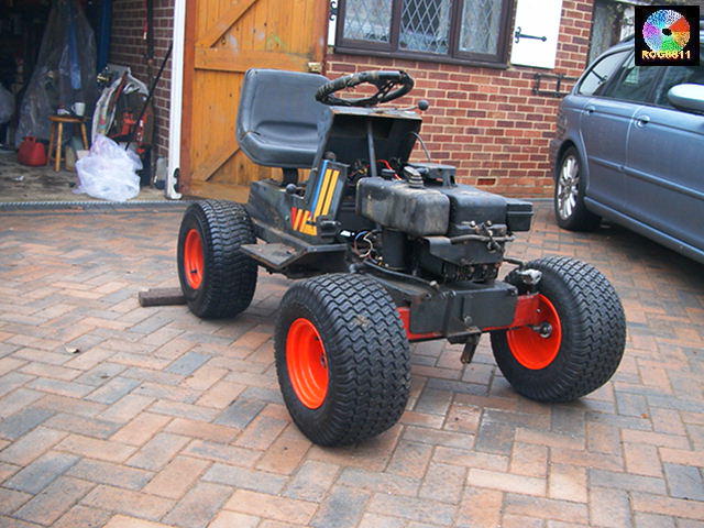

Westwood gazelle modified to have front wheels same diameter as the rears.

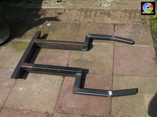

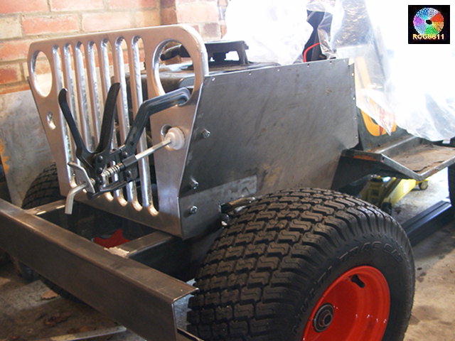

Front bumper 50 x100 box section, cut to look like channel section with my cut 40 plasma tacked up with my clarke 150.
Grill is 0.5mm aluminium swaged around 1/2" marine ply.
My main problem from now on is that I am back to a 5 day week so progress will never be very fast, I will update as I go.
Regards rog8811
