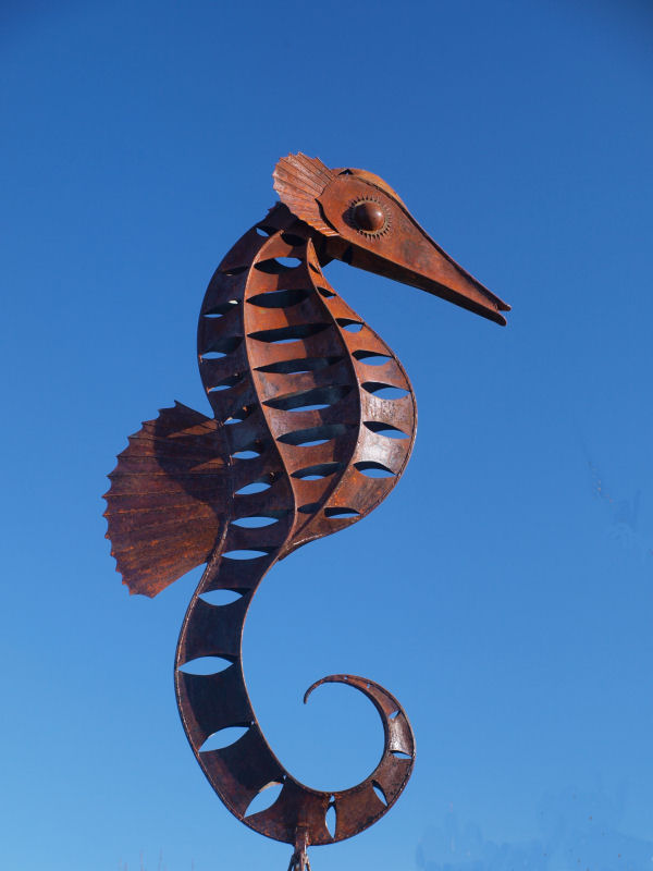

Hi Guys got this finished today.

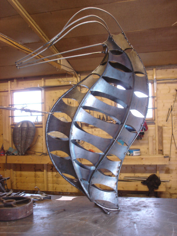

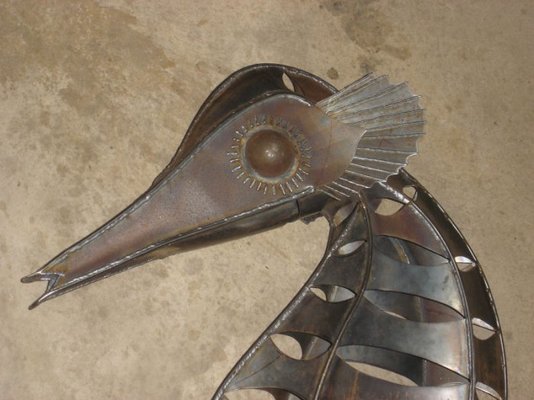

made from 8mm mild steel bar and 1.6mm sheet, treated it with ammonium chloride yesterday to get it rusted evenly, a bit soon but it is on it's way. measures 2.5m tall.

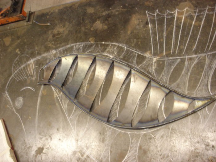

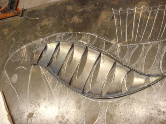

It is mounted on a piece of 30mm steel box hidden inside the bottom of the tail. Panels shapped with a mixture of big and small hammers and a fly press. On a good day I could make and fit 18 panels, one day I managed three, the sides and top of the head.
What a lucky place to have a workshop, always such blue skies (helped by a polarising filter).
If you are interested I can post some images of the build and detail shots.
