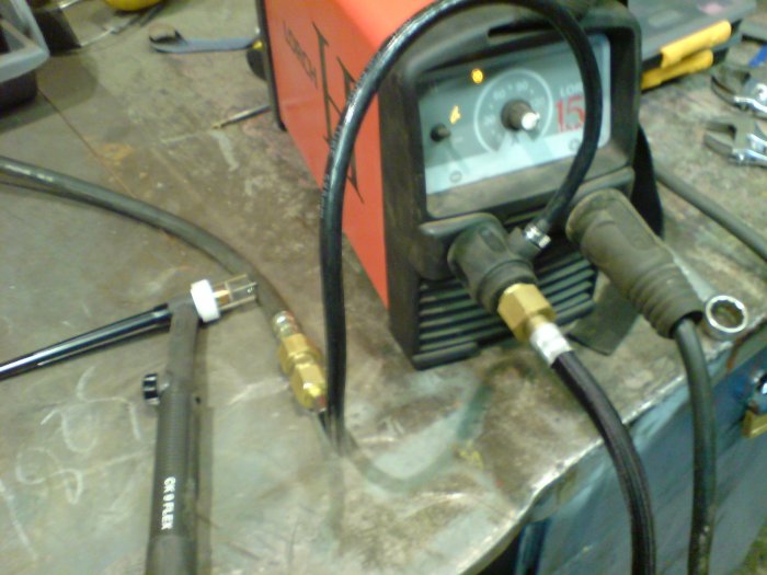

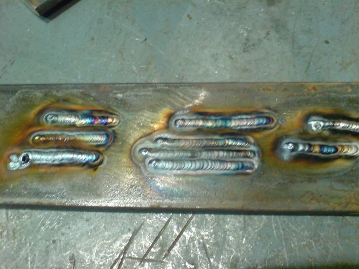

I've just got hold of a torch for my mma inverter to use as a bit of a backup incase of any probs with my other tig set. And also to have a bit of a mess about.
Starting the arc is fine.... but what are you supposed to do at the end of the weld ? The inverter just wants to keep the arc going.
What i have been doing is whiping the torch away pretty sharpish to break the arc, then putting it straight back over the end of the weld for a bit of post gas. Does this sound about the right way to go about it ?
A couple of pics.....
The set up i'm using

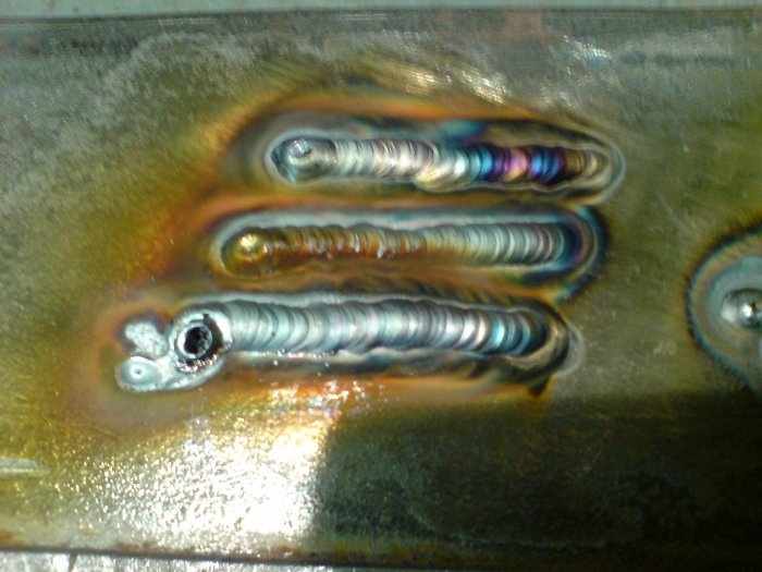

The massive crater in the bottom left hand weld is where i touched down when putting the torch back over it .

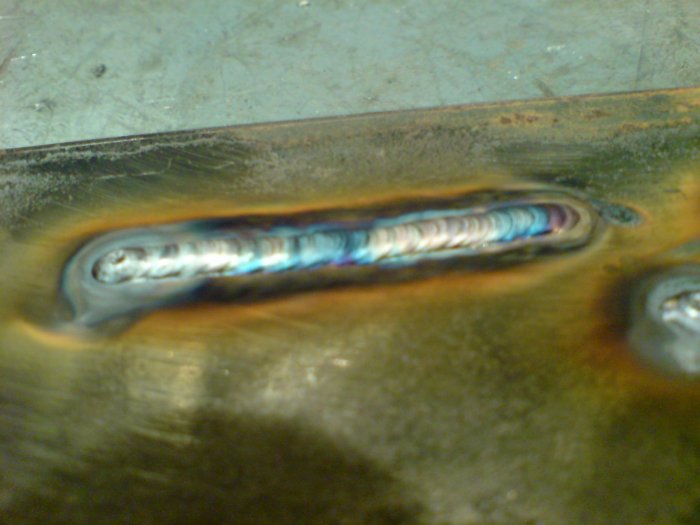

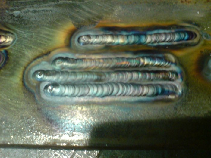

A bit of a pain when welding thin stainless tubes, but what I do to avoid the crater at the end of the weld is as soon as I add the last dip of filler, I quickly run it forward a bit before snapping the arc away (this also gives the end of the weld bead a little more time under the gas). If you can't do this because, say you're welding plates not tubes, maybe you could do the same, but instead of going forward, run it quickly back over the bead ect..
